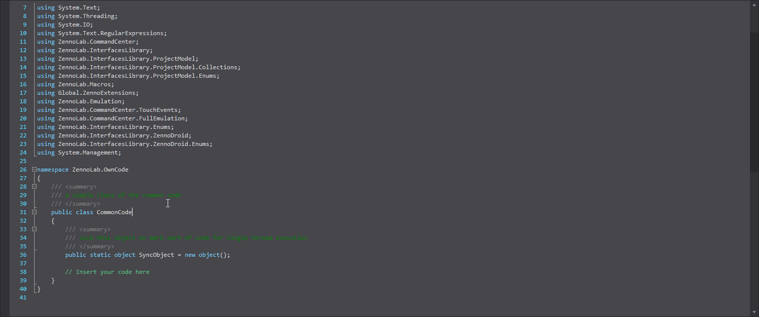

Was working on this template for a very long time, and I am no longer able to open it up in the project maker on neither of my computers, please help.
Template itself is pretty large, about 12MB in size.
@Phoenix78
@nicanil
@VladZen
@ibred
@Zymlex
Tagging everyone because it is very urgent :bc:
Here are the logs in attachment-
And this is how it looks, just loads and nothing opens up, tried it MANY times on different computers - only this template doesn't work.

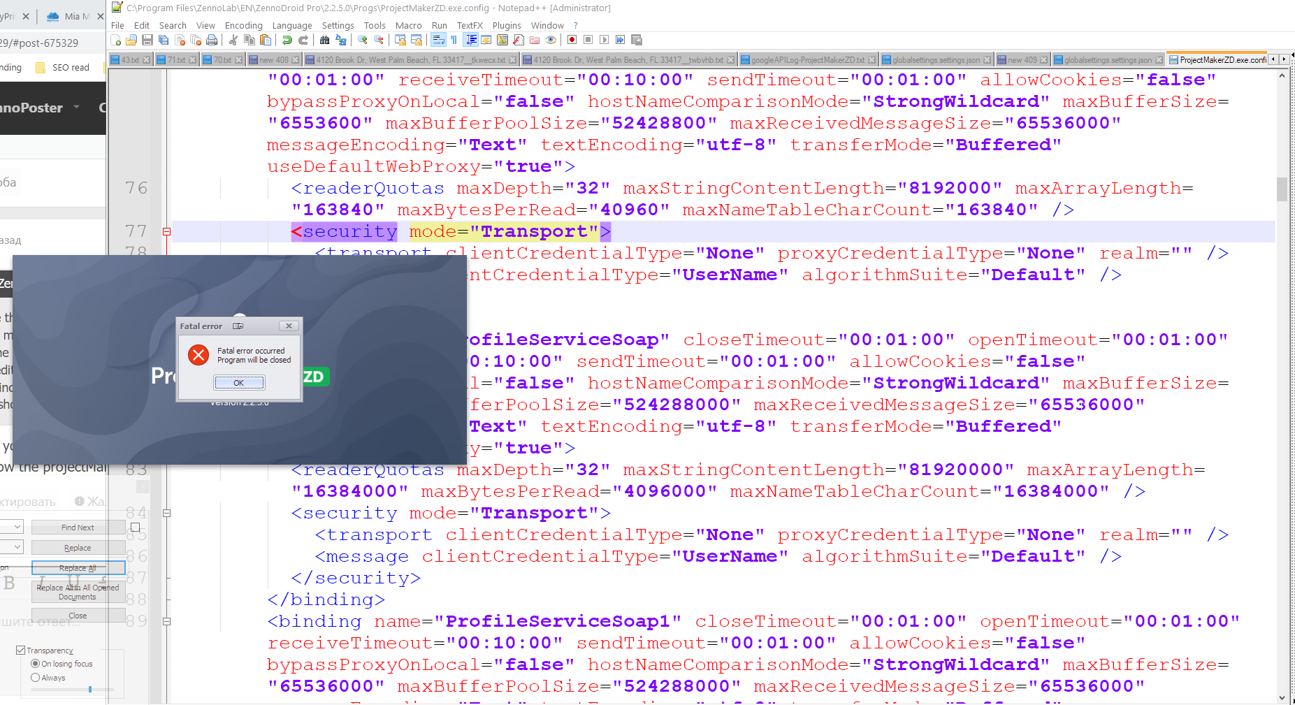

I see this error in logs:
"The maximum message size quota for incoming messages (6553600) has been exceeded. To increase the quota, use the MaxReceivedMessageSize property on the appropriate binding element."
Try editing ProjectMaker.exe.config file in Progs folder in program directory.
And increase values for MaxReceivedMessageSize adding one more zero to 6553600
You should make it for all entries maxReceivedMessageSize="6553600" in the file

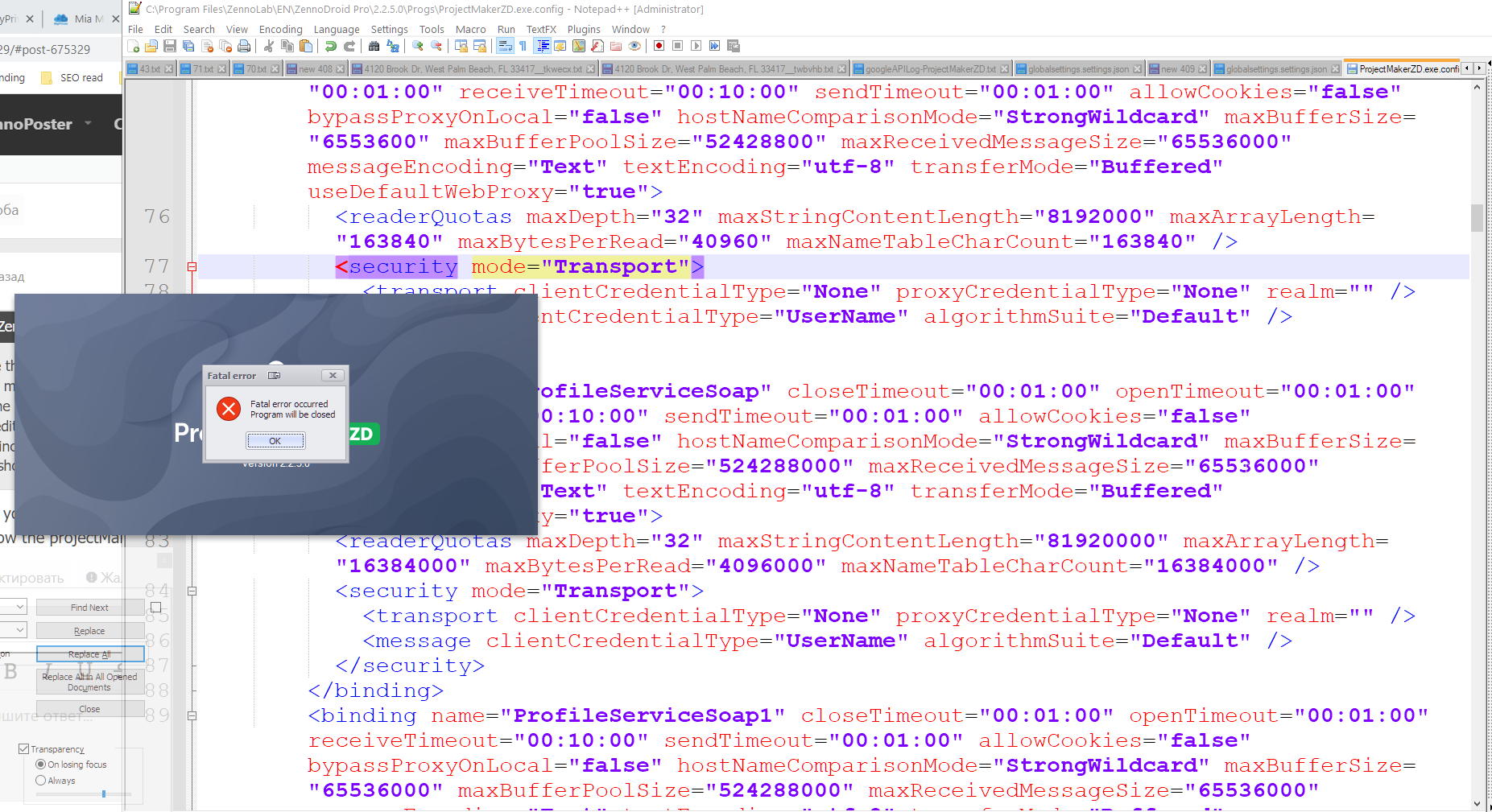

Thank you for the response, I have changed all maxReceivedMessageSize="655360 to maxReceivedMessageSize="6553600
And now the projectMaker itself doesn't even start o_O
