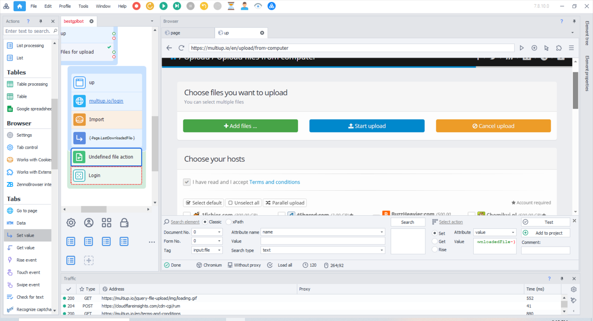

I'm having the same issue but iwth the newer version of Project Maker
I got it to work once but now I can't
