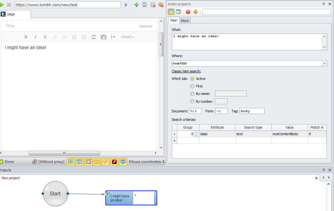

from what i can see it is working just fine...
what i used:
Tag=wysiwyg:body
did you set document and form number to -1 ?
if you let things like showed in image above that was shared by tobias then you will have issues, otherwise it works fine

Im not an beginner at zennoposter. There are only a few problems here and there for me, and as far as i know zenno gets stuck when it's "processing" java.. ect.
The next thing is, i did the same thing you did before i opened the thread. But i wasn't sure if there is a different way to do that. I just added Tobias project, and it works. Im not sure how to find that, is there a tutorial or something? I know how to use the element tree ect :).
Thanks guys for all the help, you saved me probably about 3h of my time when i will need the bot.
@dikkill
I'm using firefox most of the time to find something unique. Not sure why I chose CLASS in this example instead of ID tho. ID should always be unique, so ID would be to prefer before class etc.
Not sure if Inspect Element comes with firefox out of the box or if Firebug added that option. Check print http://tobbe.co/s/QKIXH/
