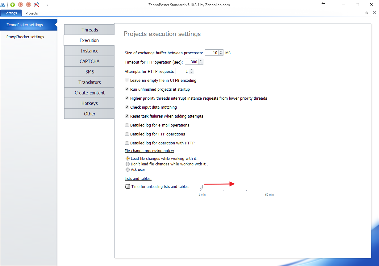

There is no limit for number of columns in zennoposter.
Try increasing this option
Реакции: Julien
