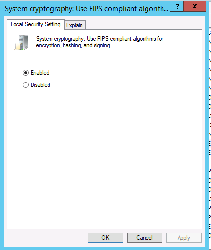

  1. Launch REGEDIT
  2. Navigate to key: HKEY_LOCAL_MACHINE\System\CurrentControlSet\Control\Lsa\FipsAlgorithmPolicy\
  3. Modify the “Enabled” value (in the right pane) to be: 0
Может кому-то поможет
