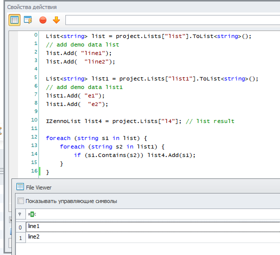

List<string> list = project.Lists["list"].ToList<string>();
// add demo data list
list.Add( "line1");
list.Add(  "line2");
List<string> list1 = project.Lists["list1"].ToList<string>();
// add demo data list1
list1.Add( "e1");
list1.Add(  "e2");
IZennoList list4 = project.Lists["l4"]; // list result
foreach (string s1 in list) {
    foreach (string s2 in list1) {
        if (s1.Contains(s2)) list4.Add(s1);

Apparently I misunderstood the problem.
You wrote that the code does not run correctly in Zennoposter, but it does work well in Visual Studio.
I took your code, inserted the demo data and see that the code is executed correctly, as it should be executed - it checks if there is a substring from the second list in the line from the first list, and if it finds one, then it adds to the third list the line in which the check for the presence of a string from the second list.

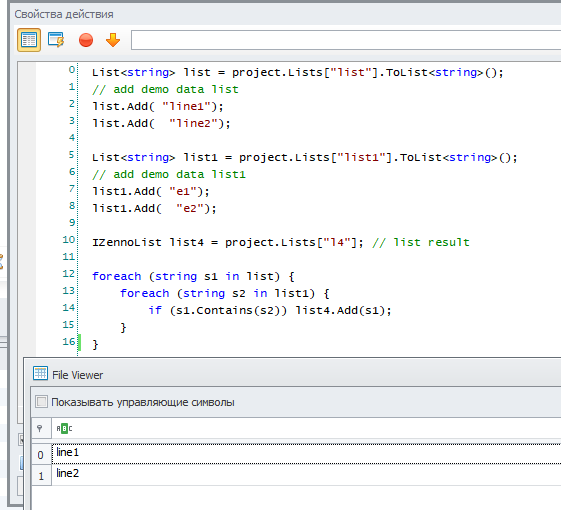

list.Add( "line1");
list.Add(  "line2");
list1.Add( "e1");
list1.Add(  "e2");

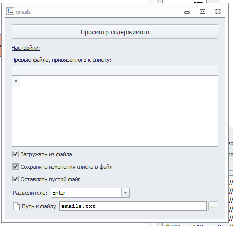

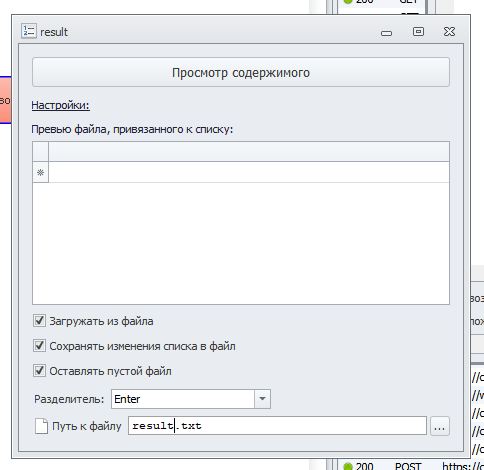

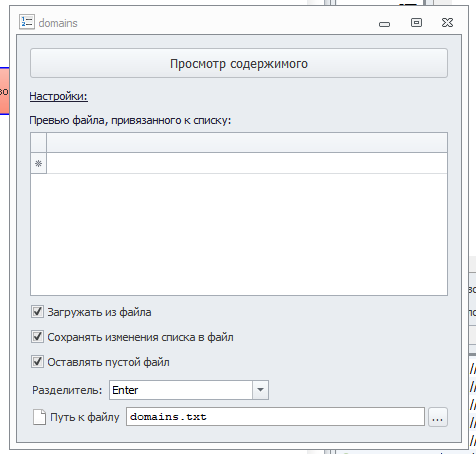

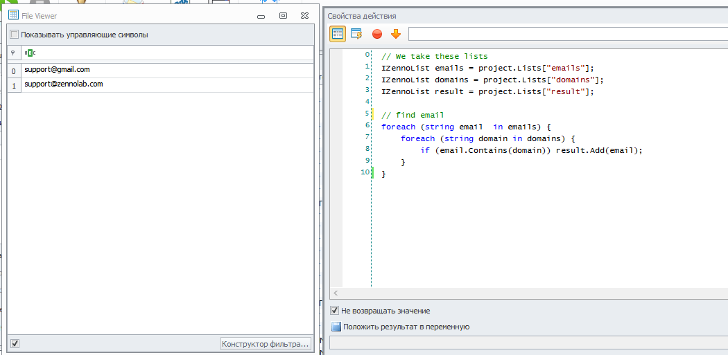

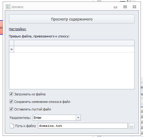

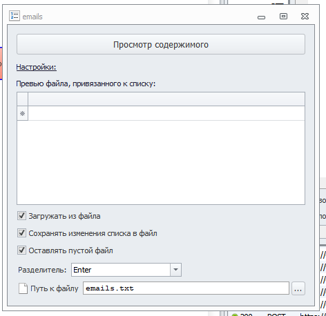

1. Create lists in a template. Link them to files. Screenshot example.
92522
92523
92524
// We take these lists
IZennoList emails = project.Lists["emails"];
IZennoList domains = project.Lists["domains"];
IZennoList result = project.Lists["result"];
// find email
foreach (string email  in emails) {
    foreach (string domain in domains) {
        if (email.Contains(domain.Trim())) result.Add(email);

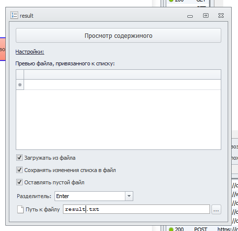

The result is found as required.
92525
Don't work properly, maybe it's happen cause list have 10k string?
Even if there are 100k lines - this should not be a problem - it will just take more time to search.
// find email

Where I can read more about these techniques in C#? Why I need initiate IzennoList, save all list to files with these flags that you show on screenshot.
I thought that maybe the code is running, but the lists do not contain data. Because of what, I advised you to link lists to files to see if the data is really there.
