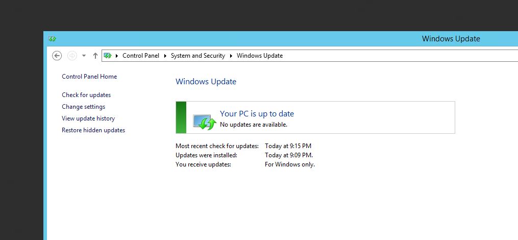

So, I have diligently looked through the forum looking for any answers for this problem, and the threads say this was a license server error, and have been fixed. However, as you can see in my enclosed screen capture, I still get this problem.
I looked over this thread, but it was hard to translate;
http://zennolab.com/discussion/threads/timezone-error-cant-start-project-maker.33036/
So I tried updating all updates for the Windows 2012 Rs Server, also the optional ones. Didn't help.
I tried updating to the time.windows.com, and all other options in that list. Didn't work.
I tried manually changing the time to be the same as ZennoPoster. Didn't work.
I then searched around the internet for issues related to being unable to have the Windows Server correct the time, but no luck there either; seems it work as it should;
I'm out of ideas. Please help?

Yes, I've installed all updates to the Windows 2012 R2 Server, even the optional ones;
