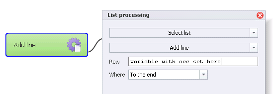

No, you have to put it back to the end of list when template finish. Use "Bad end" and "Good end" blocks to make this logic.
Something like that:
