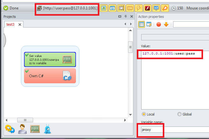

You mean this?
Ehhhh (
My bad.
I thought it would work .
I guess not.
I've set task to developers to think about how we can integrate usage of proxies with @ in passwords or usernames.
