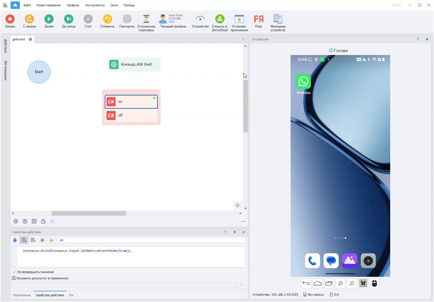

+ Added realistic touch emulation. It works on protected pages, touches are visible through getevent, and each touch has a size.
The feature can be enabled on the Settings tab using the “Use enhanced touches” option, or via C# code executed before connecting to the device:
instance.DroidInstance.Input.SetNativeEventMode(true);
