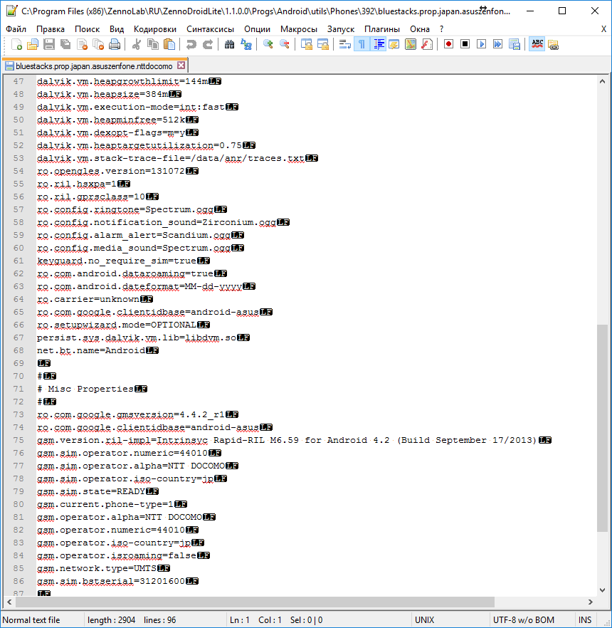

By they way, we have some pre-made configurations, which you can edit:

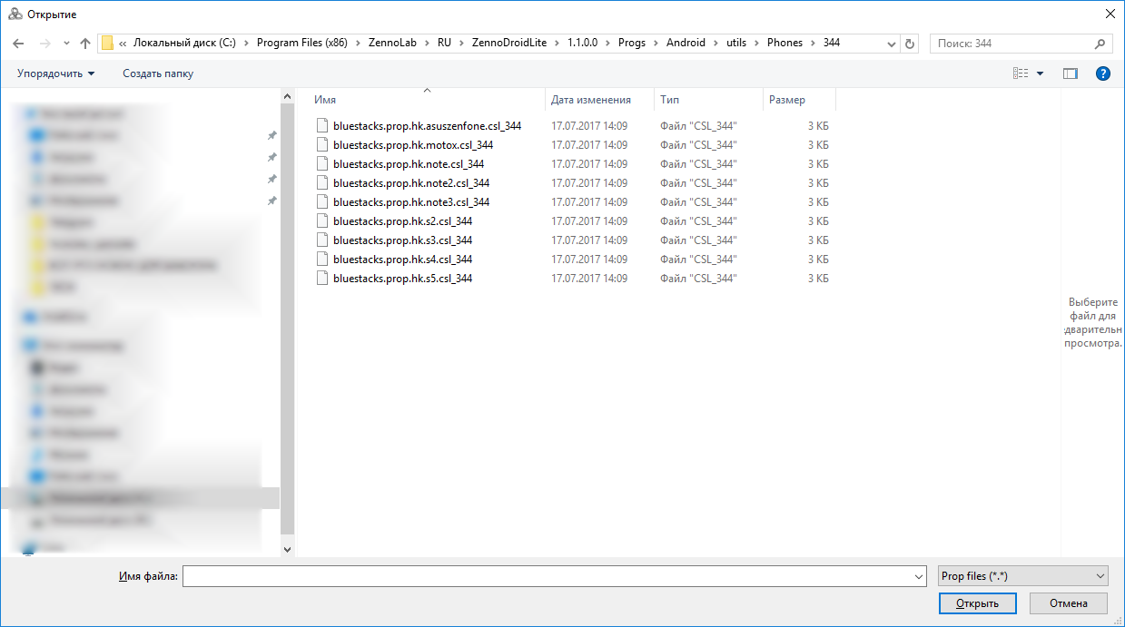

Like I said before, it would be really great if we could change the IMEI from ZD's interface. Meanwhile, I've found the files you are referring to but I have no idea how to use them. How can I apply those .csl_344 configuration files to my current bluestacks setup?
