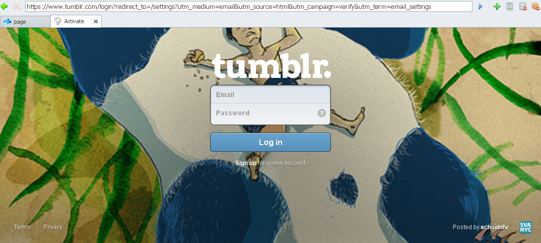

In Zennoposter browser the returned link is this
Notice the URL in ZP browser doesn't give a confirmed page and even if I log into that account all that link does is send me to the account settings page to verify the account settings. The account is still not verified

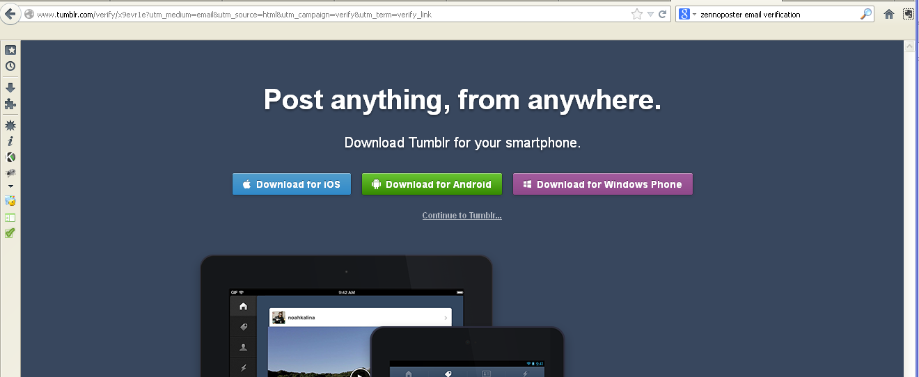

However, if I paste that same link in a local copy of FireFox it works correctly and produces this result
Why doesn't this verification link work in ZP browser but works in FireFox? It's exactly the same link and I even copied it right out of ZP variables to confirm I have it extracting from the email correctly.
