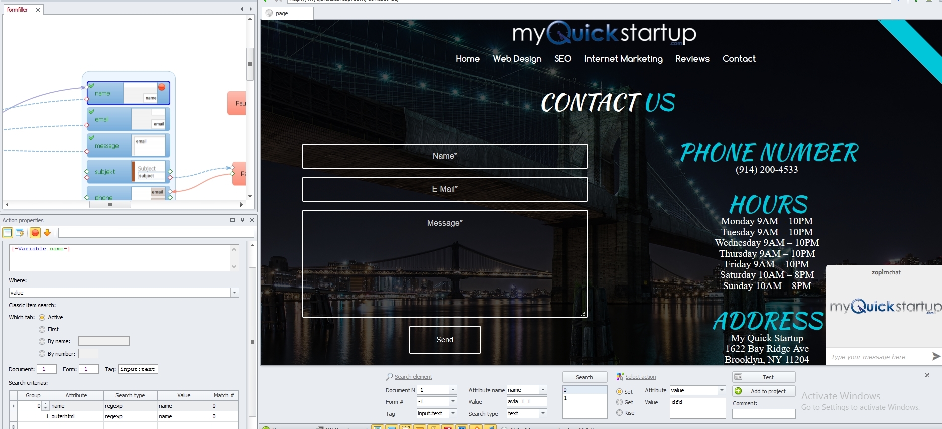

This is simple form filler. But for this contact form, when ZP try fill fields, it not filled, but looks ok, how i can prevent this, ZP not fill but go to next step?

Thanks, but problem is not how i can fill fields,then why zenno not detect, that field is not filled , why is succes this step..

Had the same problem a while ago that ZP went to the next step but didn't filled the form fields correctly. Also with "click and emulate keyboard" it didn't work every time. Sometimes it works okay, but then the same problem appears many times in a row again. I fixed it by checking the value of the first field after filling it via click and keyboard emulation and if it is empty I simply reload (via javascript) the whole page and this fixed the issue.

you are using wrong form there and that is why zenno is not giving error... form is hidden and it looks like success to zenno, but it doesnt work for you :-)
in that avia_1_1 and avia_2_1 crap right match for you is 1 and not 0.

here you go
