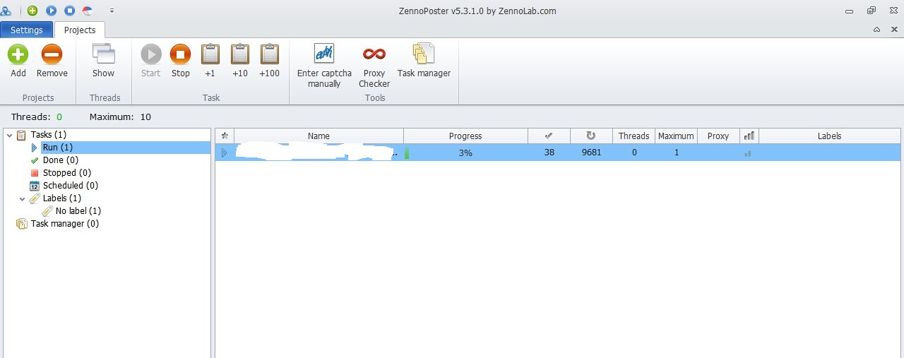

some times instance stop like this
i need restart zennoposter to active the instance

hi admin
this is the instance blank picture

usbiz
07.02.2012
yes admin i can send u the project but it countain contain many local account.can i send u email?
and you can check the picture.when the server not available.site can not loading success in project.
i need restart zp can change my pc pppoe ip.

usbiz
07.02.2012
here is the report.
and admin.i think i am sure it is the authrization server problem.because when server show not available.the issue cames out

Seems like you have problem with DNS.
Try to change DNS to 8.8.8.8 (Google DNS) if they are allowed in China.
You can also add these strings to hosts file:
userarea-hk.zennolab.com 23.97.76.156
userarea.zennolab.com 148.251.48.178
But it will help only for our servers.
