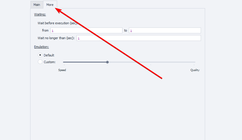

Hi, yeah some pages have some weird loading process. You can report such a website to https://support.zennolab.com/
Meanwhile all I can suggest is using C# actions for those places, where you have control over - if wait loading fully or not, and use logic where you wait for some element to appear on page and then continue when its there.
Also in actions there are More tab you can try playing with this also.
