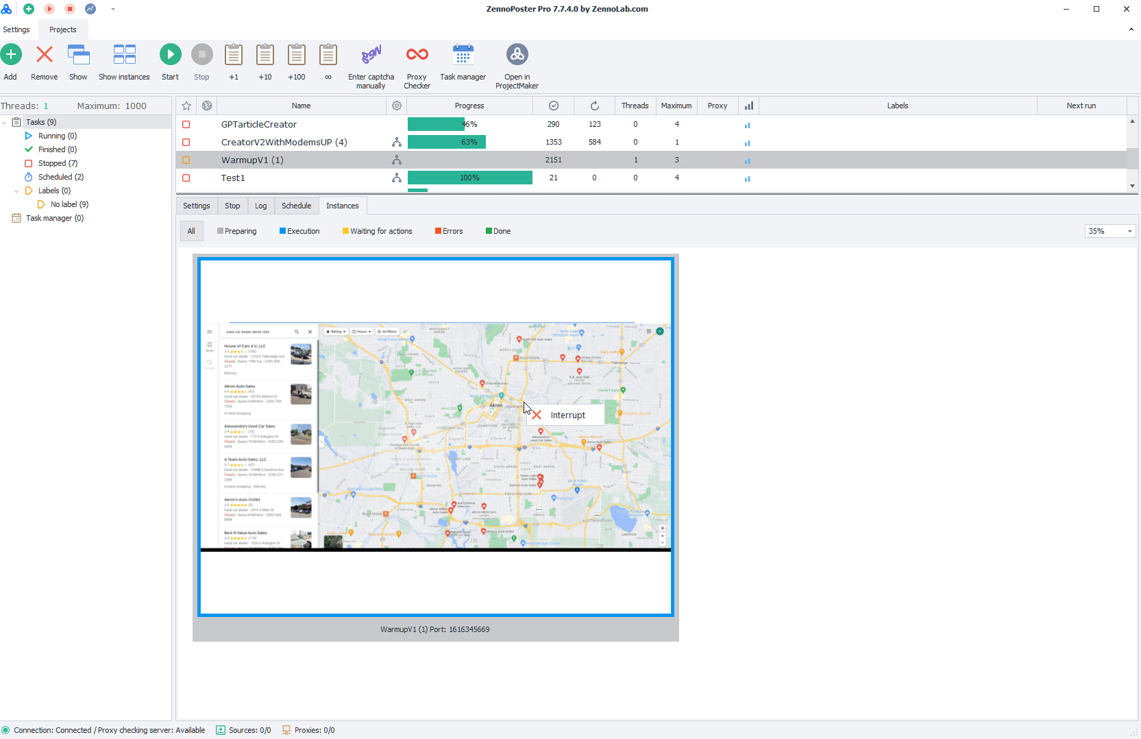

Hello, working with chromium(beta) engine windows sometimes are left stuck for hours ignoring the 'execution timeout'.
Using the newest 7.7.4.0 version
108821
In the latest 7.7.5.0 beta it seems to be improved, at least for me.
In 7.7.4.0 no way around it, and even if you interrupt the instance the browser process is still working in the background, even though you can visually see in zennoposter the red square indicator that the instance is interrupted. The only way to be 100% sure is to exit zennoposter entirely, or you run into risks of crosscontamination because of the leakage caused by the frozen background process (it loads your CPU 4-5% also :an:).

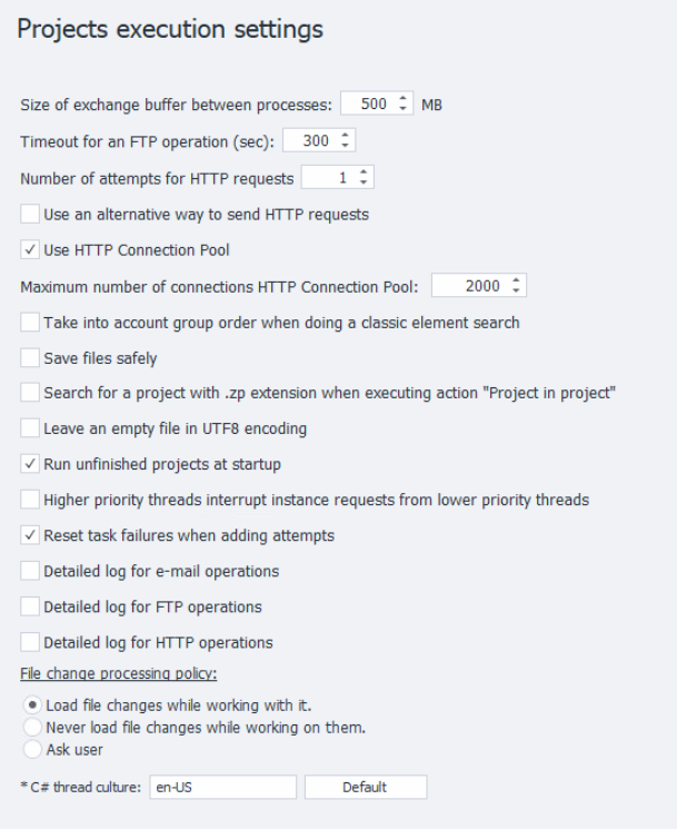

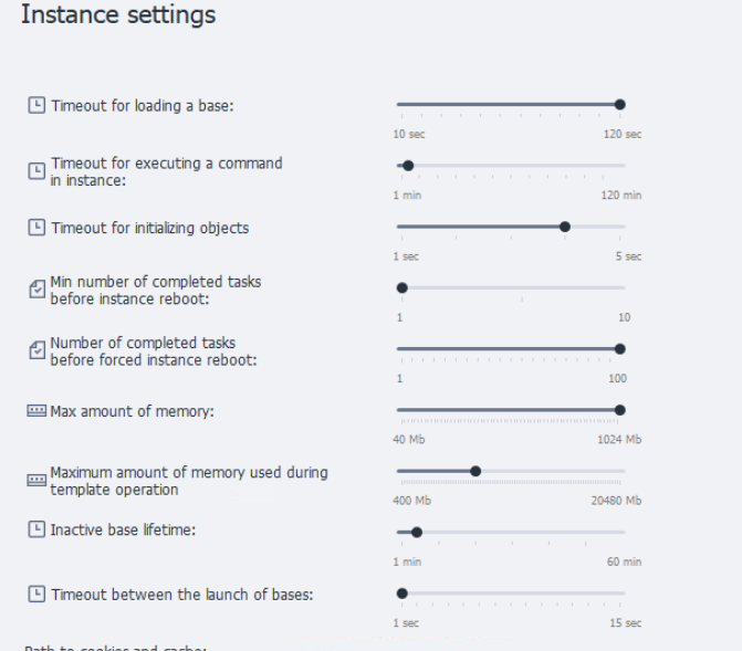

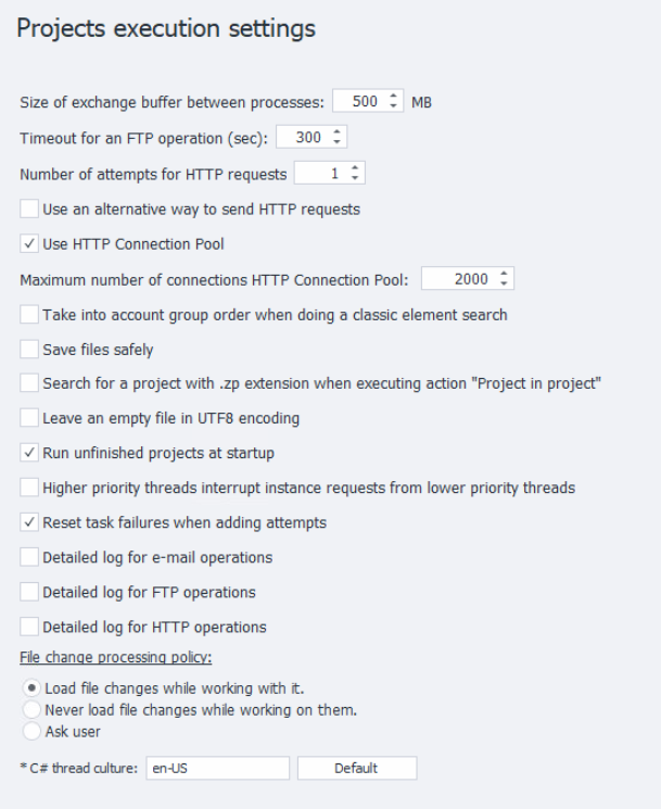

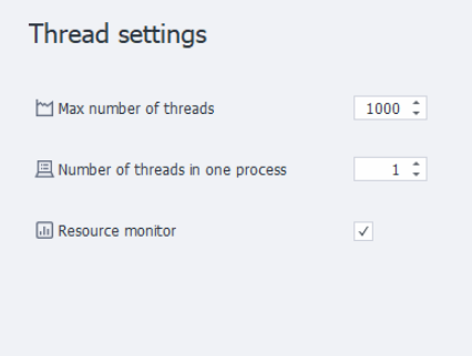

You can also try the settings I've attached, they help a tad (but you can only run a small amount of threads..). Other than that - keep begging the admins for the 8th iteration of zenno that we're waiting for almost a year already ffs..
