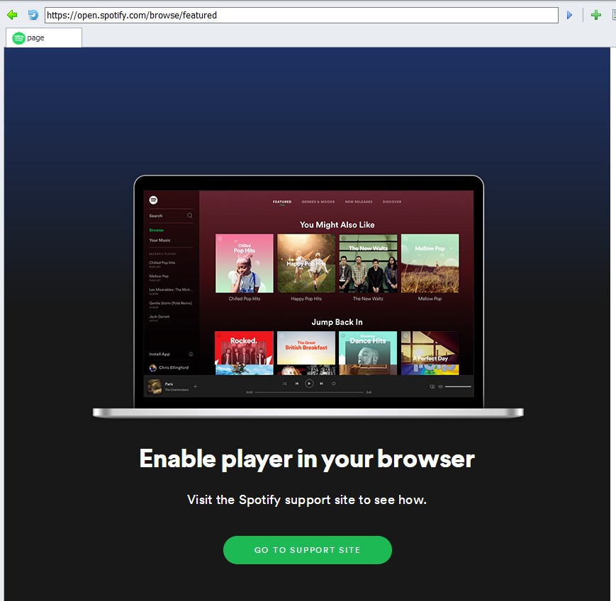

Yes, those are the instructions I followed, but I am still getting the player issue. Here are screenshots that show the .dll file in the ZP folder (I highlighted the directory structure) and a screenshot of the error in ZennoMaker when I test it.
There is a step I may be missing, so hopefully, the screenshots can help someone here identify the missing pieces. Thanks.Посмотреть вложение 40141 Посмотреть вложение 40142
What browser engine is selected in your zennoposter project? You sure it's Chrome?

Yes, here is a screenshot. I am able to load the page, but after logging in, it returns the same error.

I am still having no luck with this. The Enable player in your browser error message continues to show up. This does not happen when I play it through Chrome outside of ZP. It even works on FireFox and Edge on the same computer. I have followed all the recommendations, but there is something that I must be missing.
Would appreciate additional help on this, especially from anyone who is able to get this to work properly in ZennoMaker.

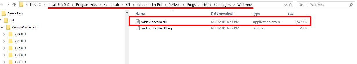

Thank you, will try it. I also assume I have created the correct Subdirectory names and placed it in the correct ZP folder as shown in the screenshot from my earlier post.

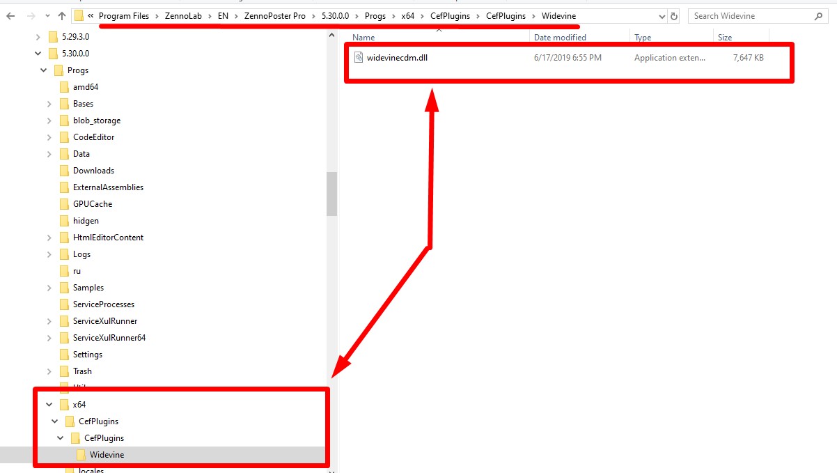

I am still getting the same failure outcome. I have attached a screenshot to show the directory path of the dll file that you attached in your response.
Also, this should have nothing to do with the version of ZP I am running correct? I have version 5.29.3.0, but my license recently ran out for me to update to version 5.30. Don't have the money to make the upgrade right now.

Did you restart ProjectMaker after copying dll?
Yes I did. I closed it out and restarted it. I just went ahead and scraped up some money to buy the update. I am installing version 5.30.0 now and will run through the recommended steps again to see if I have better luck. I will also recreate a test project from scratch with a simple visit, no proxy, and see how the browser behaves.

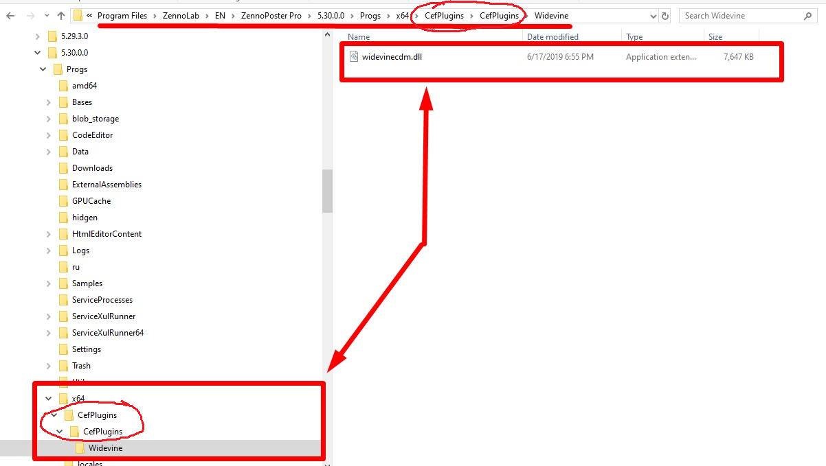

I've updated to version 5.30.0.0, copied the Cef folder in the directory, change browser settings to Chrome, added the arguments to it, then started ZM. I still get the enable player message. This is frustrating as I am sure it must be something very minor.
