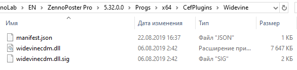

Now you need to copy 3 files from your Chrome browser to zennoposter folder. And these should be 64 bit version.
I copied widevinecdm.dll and widevinecdm.dll.sig from ProgramFiles(x86) because it was not there in ProgramFiles as stated by shThs. Already modified the browser settings by disabling the plugins and adding the arguments and installed the adobe flash aswell. The only thing I am missing is the manifest.json Can you please help me out here a little?

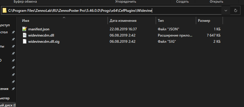

Some one can help me on 5.46.0 or 7ver. ? Already copy 3 files , to this road:
63354
But its doesnt work - restart not help.

It works up to version 5.39 beyond unable to work with these files helps me for version 5.46.0 or 7ver. ?
please
