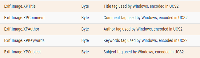

It looks like the problem is with XP tags only.
According to https://www.exiv2.org/tags.html they are used in Windows only and should be set with special encoding.
72793
Do you realy need to change these tags?
I checked https://www.imgonline.com.ua/eng and it seems it cannot change them too.

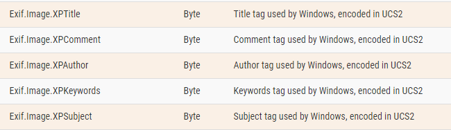

Even on this website I didn't see where to add\change XPTags. The tags I'm talking about are: Image.XPSubject, Image.XPKeywords, Image.XPAuthor, Image.XPComment, Image.XPTitle:
