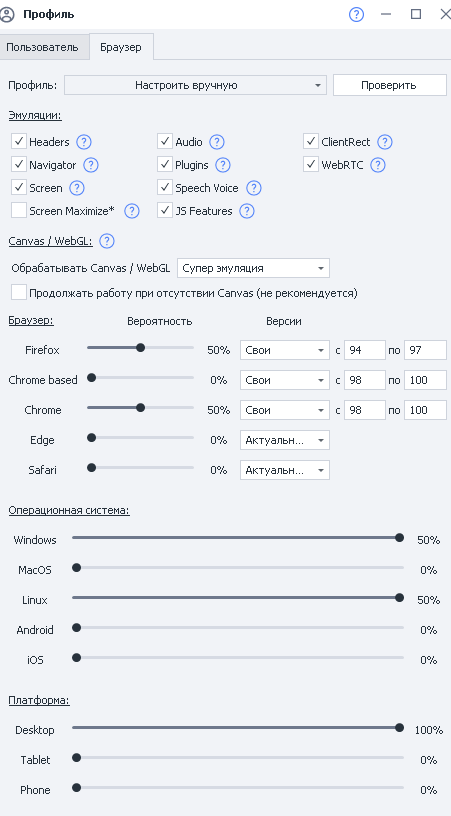

New Canvas/WebGL SuperEmulation feature is adaptive algorithm
It analyzes webpages visited in your project and if the pages detect canvas, it emulates real canvas for them.
Canvas presets are loaded at project start, not stored in browser or profile.
For better emulation, you should execute your project several times in debug mode.
ZennoPoster will learn where canvas is needed to be emulated for the project.

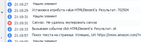

amazon store website, I constantly get such an error during registration, this error occurs at the stage of entering the code from the letter and pressing the button to complete the registration. How many times would not do runs always this error. What do you advise?

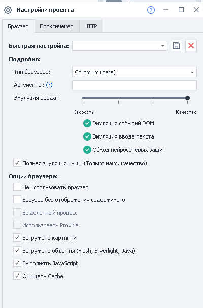

4rczi
16.02.2019
Why I don't see Super emulation options?
92986
22 412
5 899
Because it's here:
