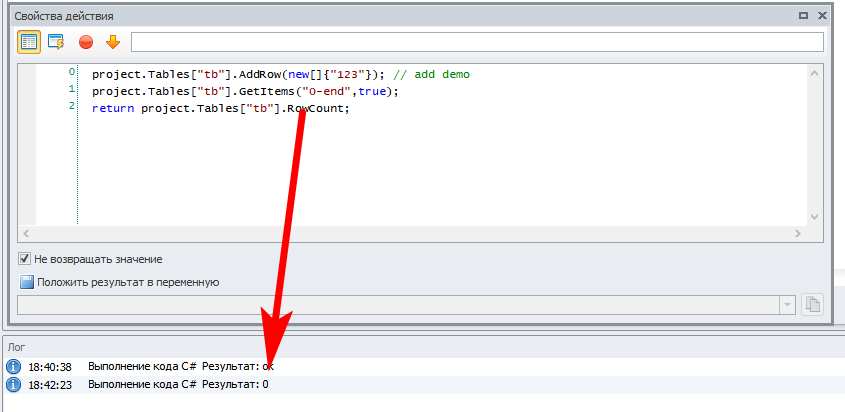

Hi, I am trying to clear the Table in ZennoPoster rather than use the ZennoPoster action.
I try:
project.Tables['leadTable'].Clear();
But this does not work. Can someone help?

project.Tables["leadTable"].AddRow(new[]{"123"}); // add demo
project.Tables["leadTable"].GetItems("0-end",true);

project. Tables["leadTable"]. AddRow(new[]{"123"});  add demo
project. Tables["leadTable"]. GetItems("0-end",true);
