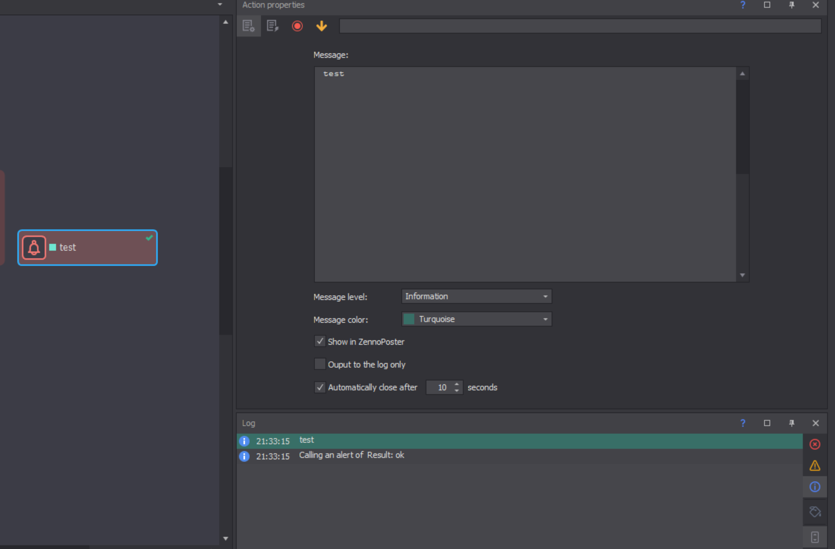

Hello Zenno Friends,
I am currently working on a project in ZennoPoster and I'm trying to figure out if it's possible to use the notification button to customize the colors of log messages through a C# script.
Specifically, I'm looking to set messages with colors like turquoise or other custom colors for enhanced visibility in the logs.
I've been looking into the ILogOptions interface, but i didn't find on how to implement these specific color settings.
Does anyone have a code sample or guidance on how to proceed with adding this color customization to the logs?

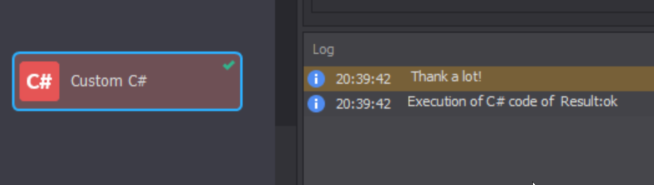

project.SendToLog("Message", ZennoLab.InterfacesLibrary.Enums.Log.LogType.Info, false, ZennoLab.InterfacesLibrary.Enums.Log.LogColor.Yellow);
