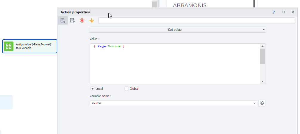

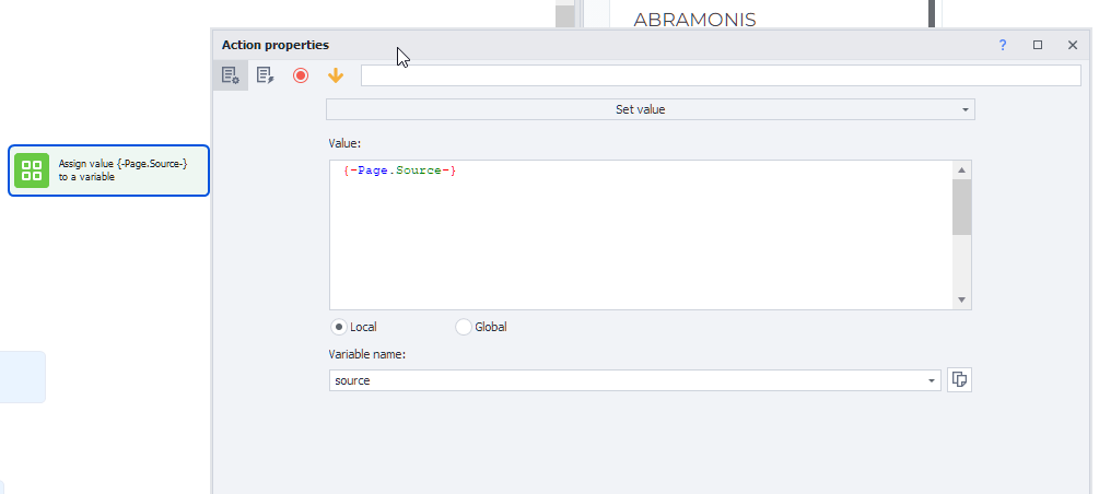

Create a cube like this when the page is loaded.
Make a screenshot of the page
Upload the value of 'source' variable here (all the HTML) and the screenshot

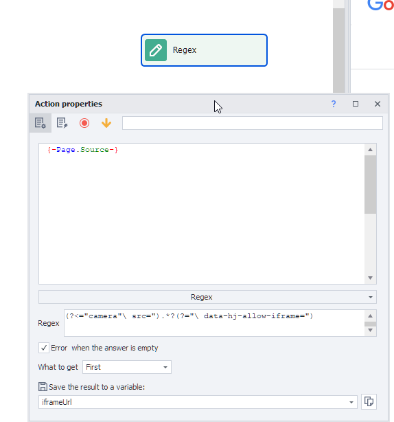

Thank you for the help, it helped me a lot. If it's not too much to ask, could you help me extract this URL from the script (source) or from the source variable and then use it as a URL?
myndeswx
15.05.2017
424
99

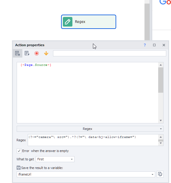

Create a cube like this, the regex to use - (?<="camera"\ src=").*?(?="\ data-hj-allow-iframe=")
Check out the regexp builder in zenno, it's a very easy to use tool and you will 100% need to use it in the future, so just get used to it now ;-)
