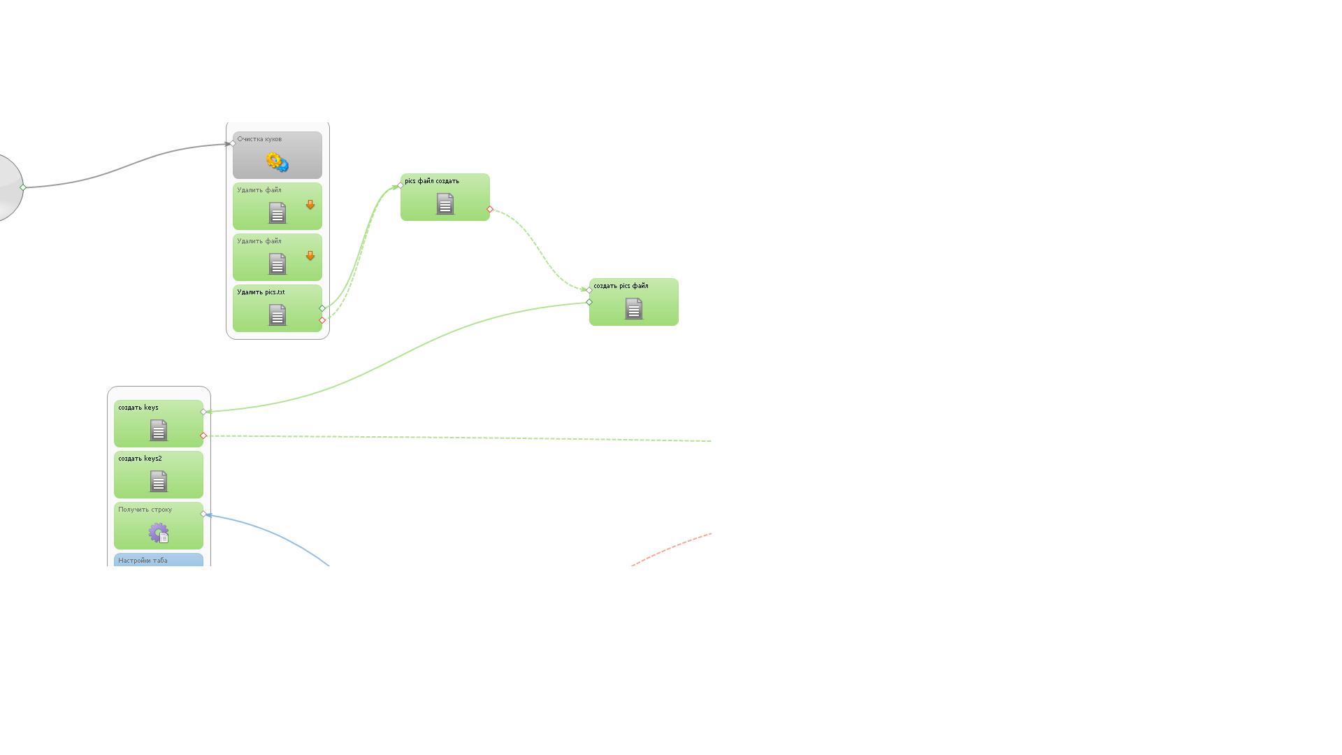

Devostator
17.09.2011
285
33
29 068
5 724
It works

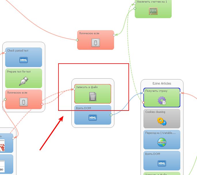

Maybe forgot to save the last version of template and the old one was archived.
As i can see there s no bind to file action on your screen.
  • 13,4 КБ Просмотры: 368
Реакции: Devostator
This is VERY strange, when you combined the actions - it works.. thanks a lot for time spent!
