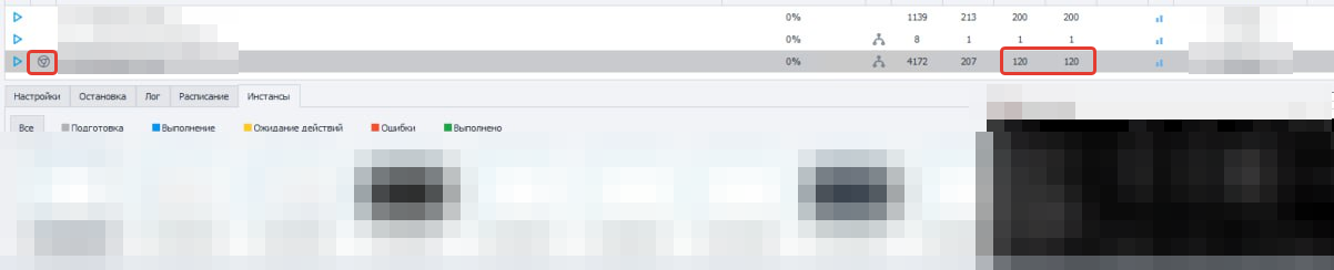

Look closely, I have 120 browser threads running in Zennoposter + 200 non-browser threads. I can run more, 150 browser threads are running safely around the clock. https://zennolab.com/discussion/threads/good-computer-more-than-100-threads.112740/post-749648
Well, the fact that you can not run more threads, it's not my problem. on another computer, Ryzen 7 2700 + 64GB, I run 70 threads in Zennoposter.
