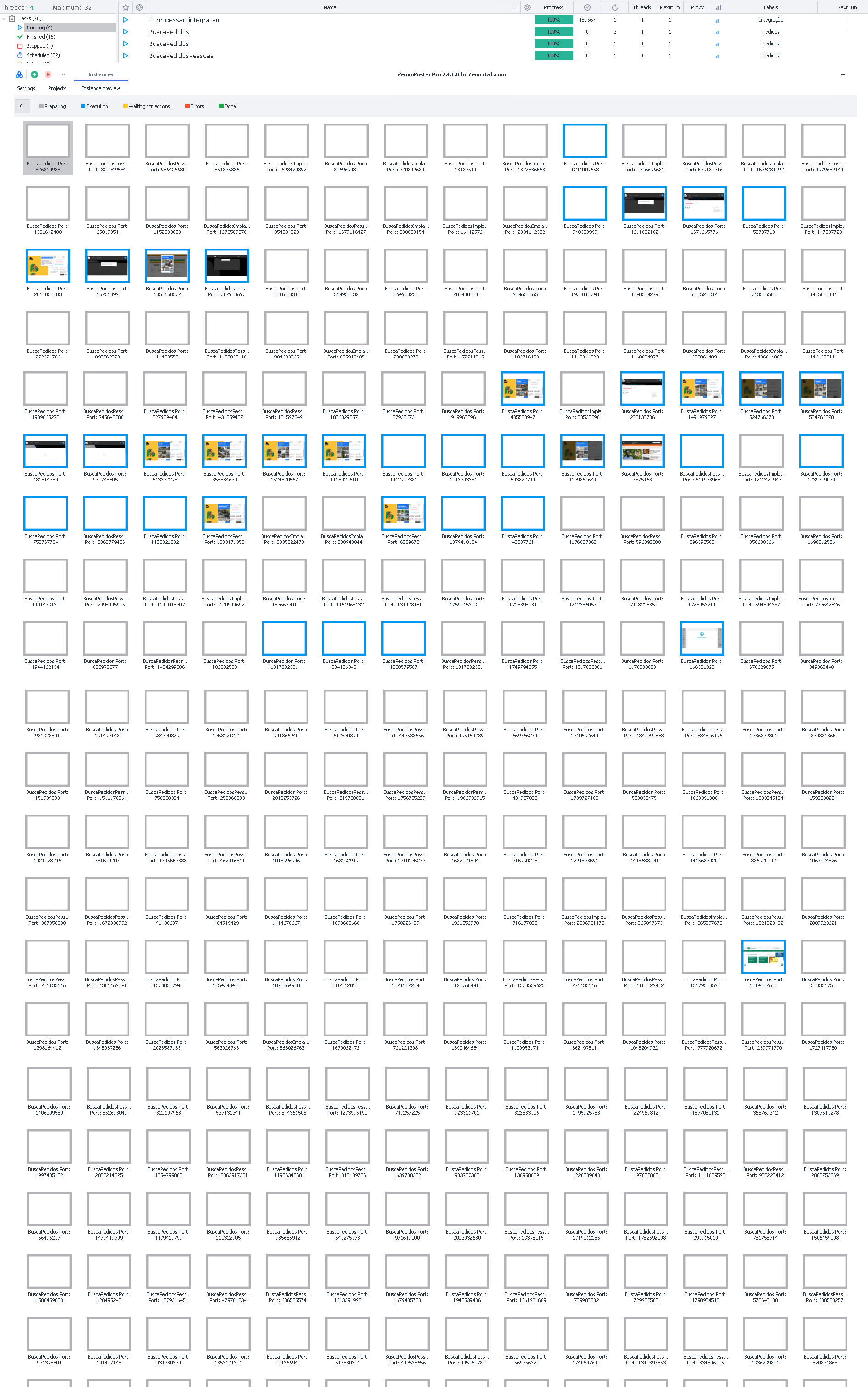

As far as I can see, many instances displayed as preparing (grey border)... seems they didn't even start...
Did I ask you to show the screenshot of Instance tab in project settings?
EtaLasquera
02.01.2017
527

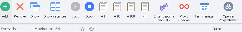

No, it was taken form Zenno Poster, "Show Instances" button.
Not only grey border are zombies, some active (blue border) are zombies.

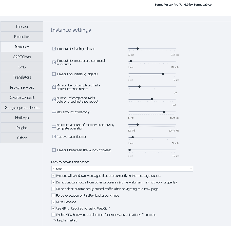

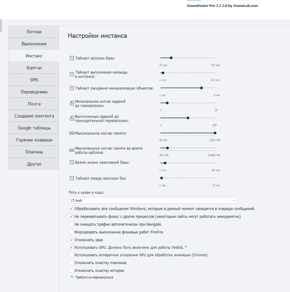

7.7.3 I think it's default settings:
106115

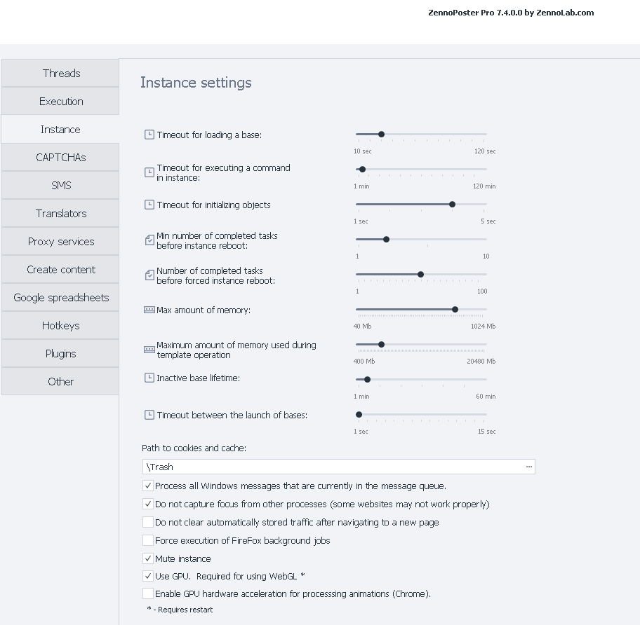

7.4.0 Default settings too
106116
