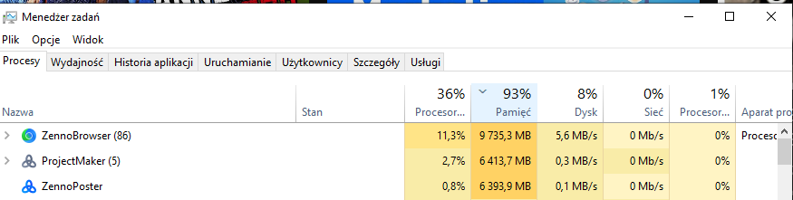

How can I make so zenoposter stop using whole RAM on my computer, i have 32GB ram and after couple hours of zenoposter working only with 5 threads it looks like this:
I'm working on project in which zenoposter would have to run 24/7 and i can't go and manually restart it every hour.

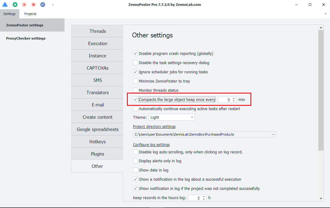

Try enabling this option:

In case of this screenshot it is webarhive.
But for this 24/7 project are just majestic API and Goodady api. But in this case problem is large amount of Data. I split XLS files for smaller files so they are essayer to handle but i still have 6GB data of just excels from 1 week of work and i do have to keep bigger master excel file that is 800MB which have its own process for transferring and filtering out data from smaller files so i don't have to work with this file on multiple zennoposter instances. I think problem is with not closing instances there are 86 instances of zennobrowser while it should be using max 5 at once.
