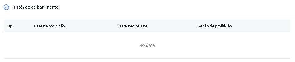

What is said in the ban history? -https://capmonster.cloud/BanEvents/History

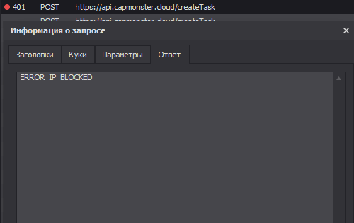

From Zenno Poster Log:
Type Time Message
2023-03-08 13:28:23.111 CapMonsterCloud ReCaptcha2. ERROR_IP_BLOCKED
How much data we sent? 25

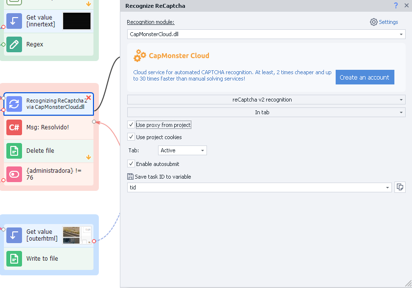

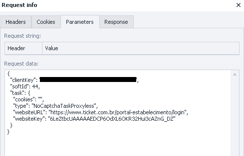

How we setup capmonster recognition:
104201

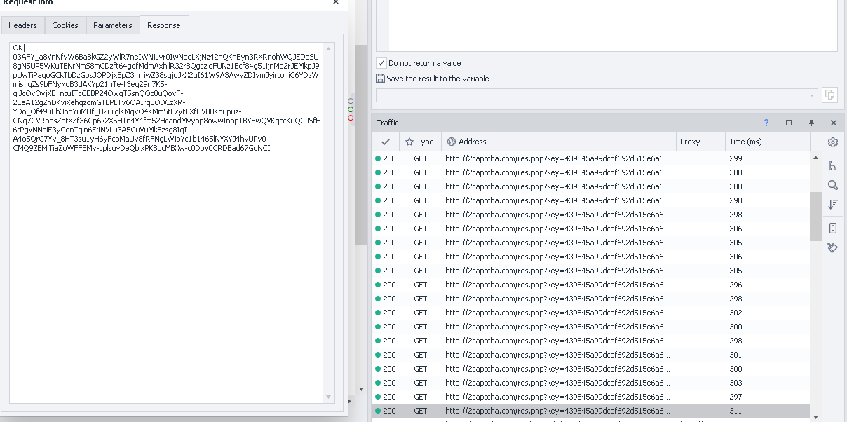

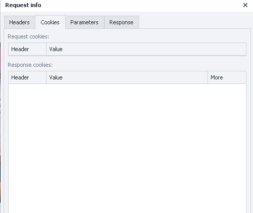

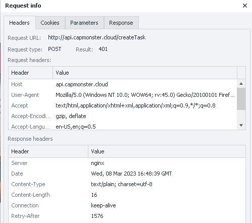

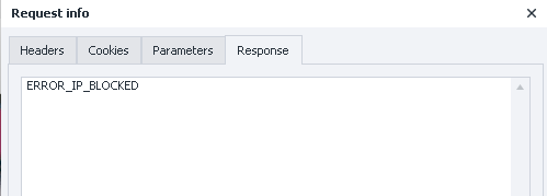

Resoponse:
104197
104198
104199
104200

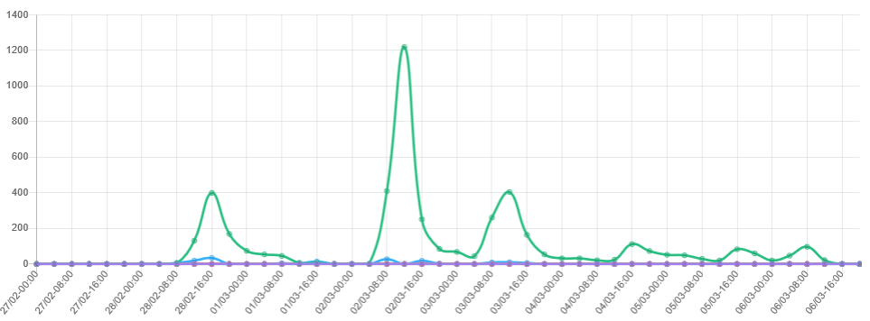

Traffic:
104202
