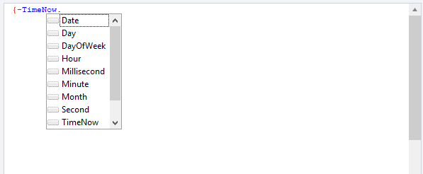

(current format is MMMM dd, YYYY
    12 KB · Просмотры: 138
    7 KB · Просмотры: 144

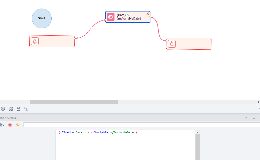

Actually I had
{-TimeNow.Date MMMM dd, yyyy-} < {-Variable.ReleaseDate1-}
Which still gives the slightly different error but it looks perfect in the logic/return
(will always return false, unless the month is the same then it will give correct information)
99198
