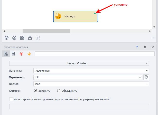

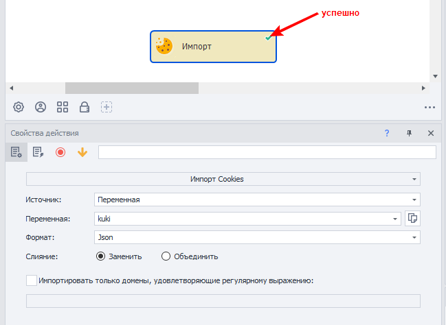

С этой кукой из первого поста:
[{"domain":".ads.google.com","expirationDate":null,"httpOnly":true,"name":"S","path":"/aw_reporting/reporteditor","secure":true,"value":"adwords-frontend-reporting=14CSpmhEekpGIbeIZFRwVjbKKjuN13h9_7dwmQ-wwmU"},{"domain":".ads.google.com","expirationDate":null,"httpOnly":true,"name":"S","path":"/aw_prime/opportunities","secure":true,"value":"adwords-frontend-prime=0gOjydIxwqxPCPLQIXG96pnvJEHaKNsYVrkc7XGIRuA"},{"domain":".ads.google.com","expirationDate":null,"httpOnly":true,"name":"S","path":"/aw_express/management","secure":true,"value":"adwords-frontend-express=PnULMgrTU9hjI4DuCZHtYJQEUmh9zUUcdvFGIgF2e5k"}]
101508
