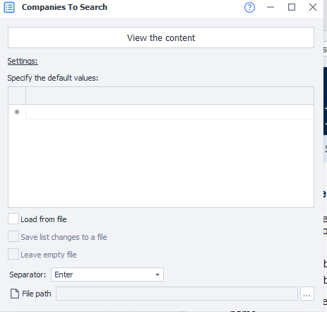

This depends on list format and how you work with text in it.
So, please attach the screenshot of list properties

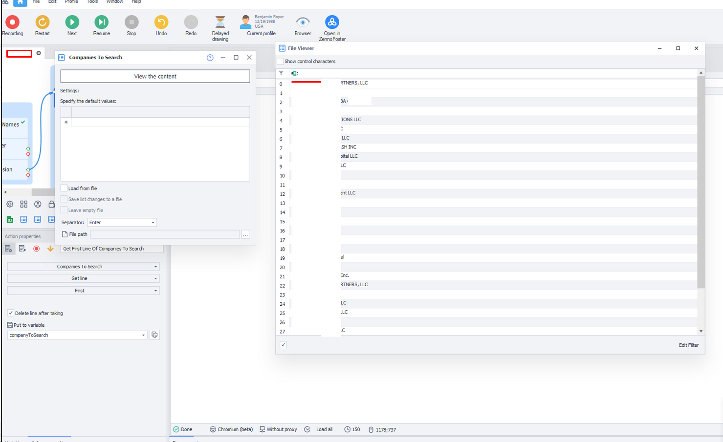

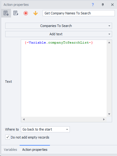

When I open the list, all the entries are on the correct lines. Here are the properties.

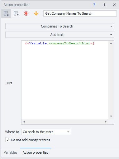

I first get the list of companies and put it into a variable.
103491

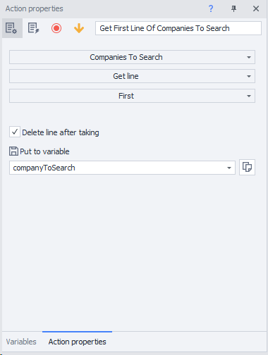

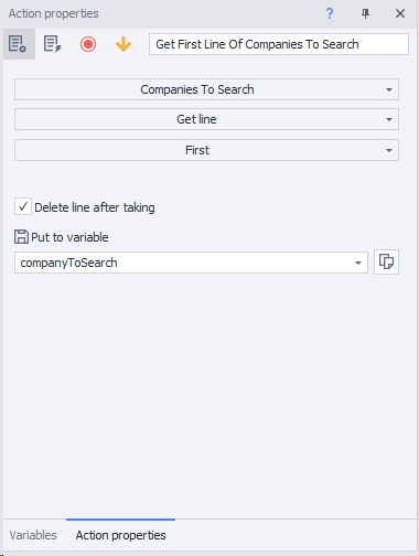

Then I get the first line of the list.
103492
At that point, the list shows the correct lines on the correct rows.

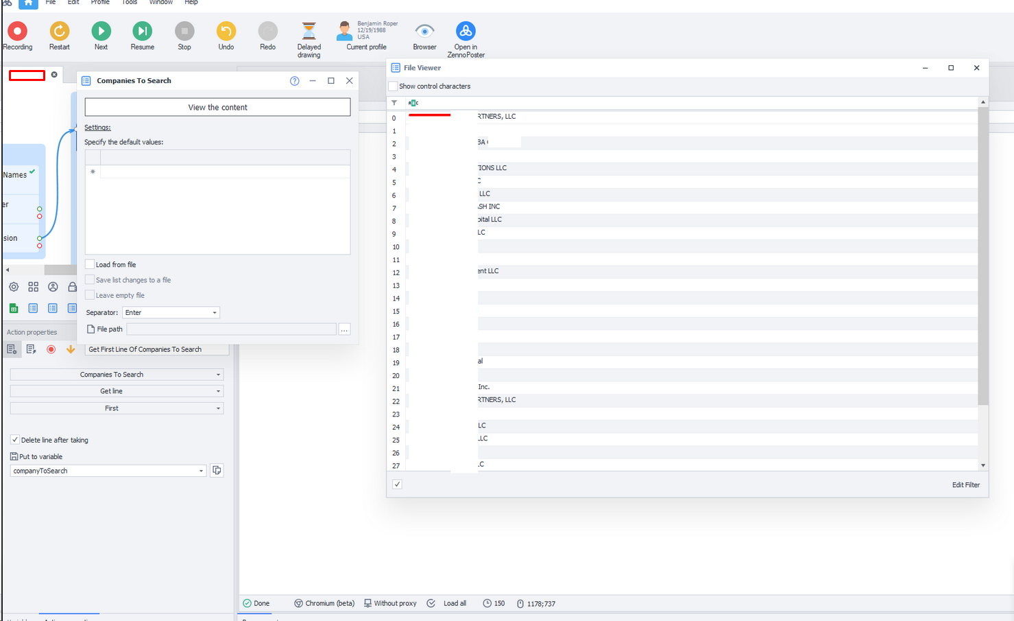

@VladZen Maybe I am misunderstanding you.
And as I said, it runs fine in ProjectMaker.
When it hits the first field on the website, only while running in the Poster, it instead writes all lines into the field.
It seems your fist step is incorrect as you add text not formatted for list.
And later, when you getting line, it takes the whole list.
I would recommend you to load list from file where you have the list of companies.

@VladZen Your suggestion worked. Thank you.
I really wanted to be able to allow a user to input the list directly into the UI though.
I am guessing that even though each item is on a new line, ZP does not read the new line and reads it as a space or tab instead.
Odd that it works in Project Maker, but not ZP directly.
