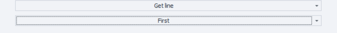

Also, on the drop down of with "Get Line" - First (Does this mean grabs the first line of the list)? If so then I need a way to be able to grab email1 on the first thread, email2 on the 2nd thread, email3 on the 3rd thread, etc.

Hello and welcome.
You can create a file with today's date in the name. And copy all emails from your main .txt file into .txt file you create every day with a date in txt file name.
Then just take the first or random line from the file and delete that line. There is a checkbox - Delete line after taking.
This can be a logic for using the same emails every day. You just have to schedule your template to run every day.
As per your question about threads. If you take the first line from your txt file and delete the line, then the next thread will take the next line and next thread next and so on.

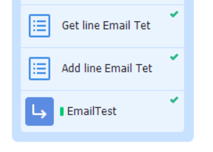

Thank you, since my email list is so long and may not get through the entire list, I think I am going to just get line and add line to one list.
113319
Get Line - First, delete line after taking
Add line - add line, Get line variable in the row field
This way I can just cycle through the list every day.

Thank you, since my email list is so long and may not get through the entire list, I think I am going to just get line and add line to one list. Посмотреть вложение 113319

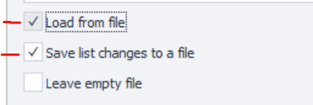

It's a smart approach, and it could work if you had the 'save changes to the file' unchecked, and you would not actually need to add any lines back, BUT this will not work in multithreaded. Because this would be an infinite loop, it would keep taking and adding lines back to the file forever.
This should work
