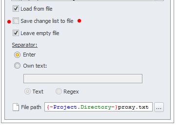

In PM 5.0.4.2 there's an issue with list processing in debugging.
I keep getting message: 'Action not executed' every time I try to get line. I've checked all file paths ok (always use {-Project.Directory-} with correct file).
I tried this in PM 4.5.0.2 to make sure, and it works ok there.
Thanks.

I managed to find out why it wouldn't work.
In List, if I check the box: Save changes to file, I get error message all the time.
Need to add that this happens inList processing > Get line.
So now in List processing, I choose delete line after take, but cannot save file as it shows error.

The error is: 'Action not executed'. This only displays in debugging.
Software isn't run as admin, although it is shown as Windows Vista (SP2) in compatibility mode (btw, I haven't touched this setting when I installed ZP).

Managed to get it running ok after I did a fresh install.
