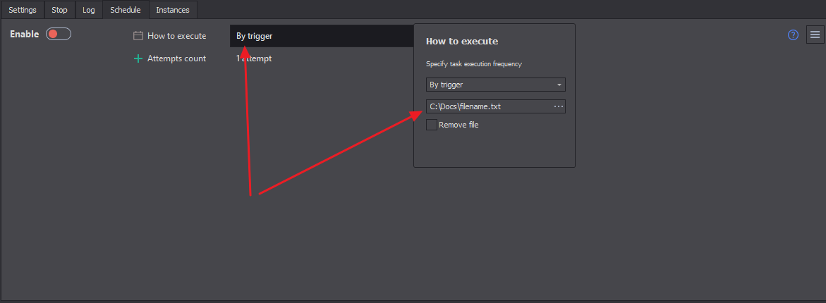

One project creates a file, which triggers execution of another.
You can select to run a project by trigger in Schedule settings.

This is what we are looking for, but I can't seem to make it work because i'm not well rounded in c# could you point out what's wrong and how can i make it work?
With get task info method I can check if a project is idle or running, if it's idle then it has completed the work by reaching the maxium success count or max failure count or whatever condition that was set, if task info returns the project is still running then it hasn't finished the work, I just don't know how to set it up because i'm a c# noob
