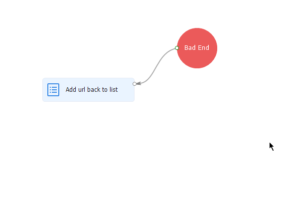

Can you check for me if it's correct, just like in the image?
I added the (bad end) together with the function, but whenever there's an error in the bot, it doesn't go to (badend). So I added it there, it reads the URL, and if there's any error, it goes to the function of playing the link again on the list, which is the URL file."

Bad end works just once. And it works whatever error is thrown.
You don't loop anything after bad end. You just finish, add url back to file and let other threads take care of repeating.

You should try different ways and test and see how this works, man. :-)
If any error happens Bad End will be executed. So you connect any actions to it you want gets executed after any error on the template.
