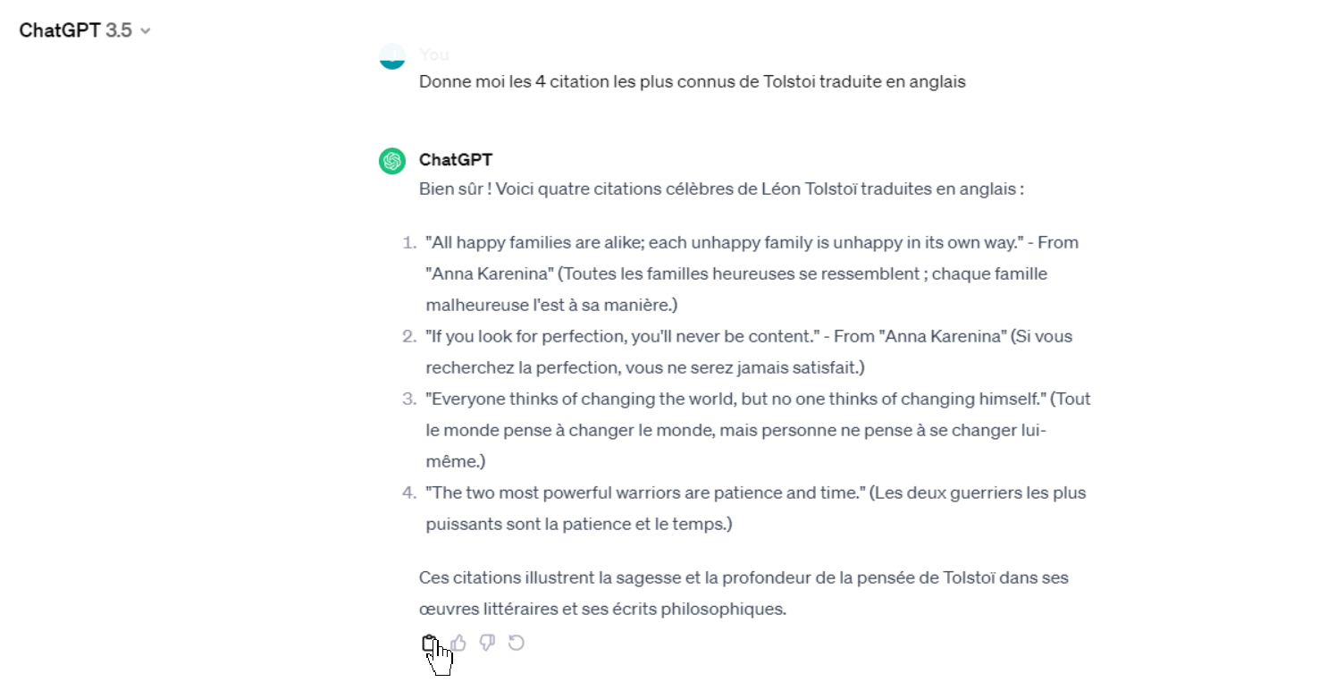

  1. I have successfully identified and clicked the button using ZennoPoster's Action Designer.
  2. I attempted to retrieve the content from the clipboard after the click action, but the clipboard remains empty.
The content I'm trying to copy doesn't seem to be present in the button's source code, suggesting it may be handled by JavaScript.
Could anyone advise on how to properly simulate the button click to retrieve the content as it happens with a manual click? Or is there a way to execute the associated JavaScript within ZennoPoster to achieve the same result?
Any insights or suggestions would be greatly appreciated as I am unsure how to proceed with this issue.
Thank you in advance for your help!

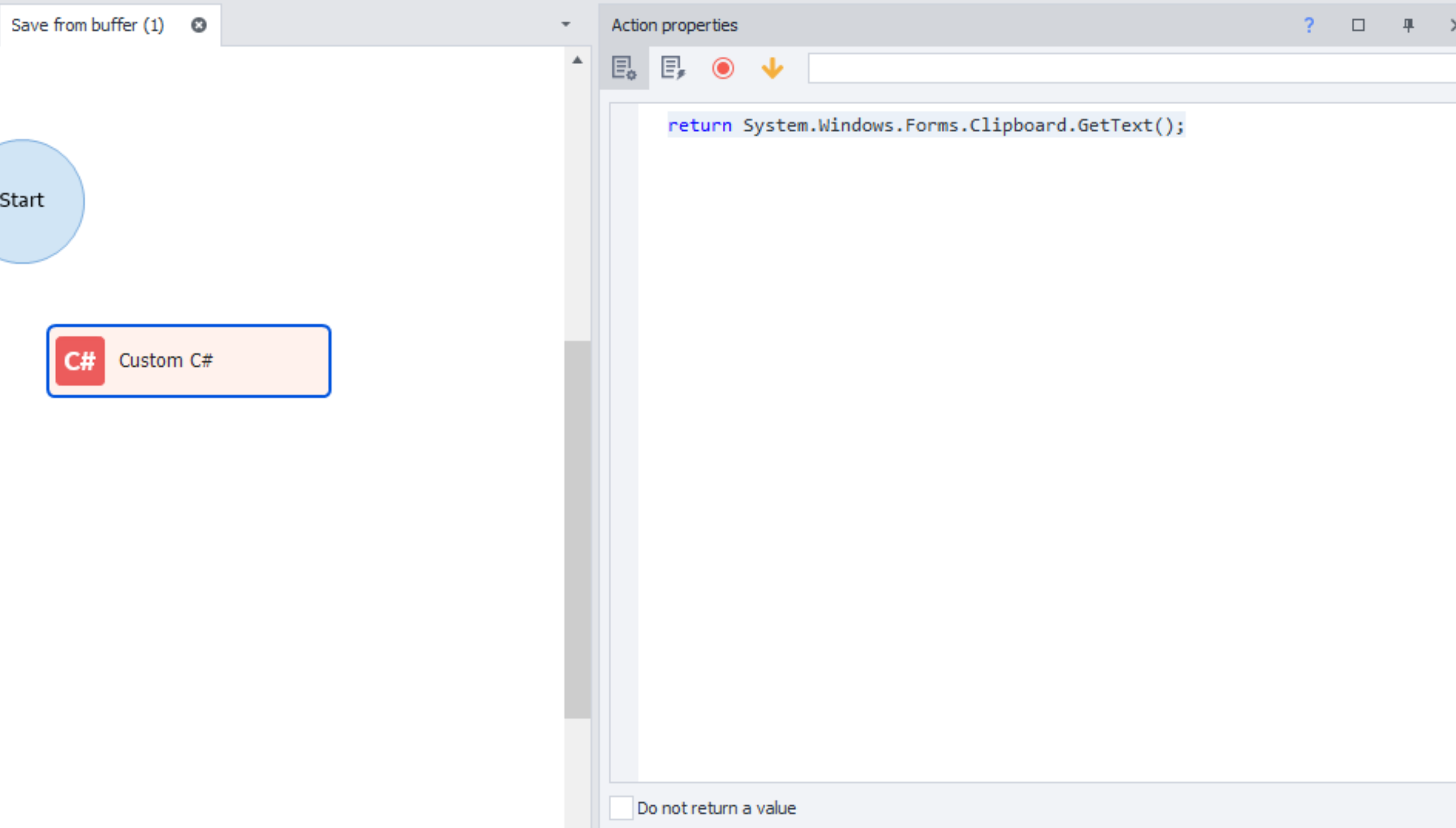

Thank again for your reply,
i am beginner and english is not my language so sorry because i was not clear
115358
i tried you ZP/ Code,
but this is apropriate for the next step : get the content FROM the clipboard.
My trouble is i CAN'T get the content in the Clipboard,
clic on the bouton don't copy it in the Clipboard.
You should run this code after you copied the content to clipboard from your GPT.
The code saves content from clipboard to the variable. Look into the variable value.

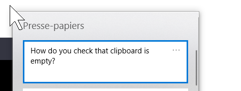

How do you check that clipboard is empty?
Pierre Paul Jacques
Активный пользователь
08.10.2023
126
34

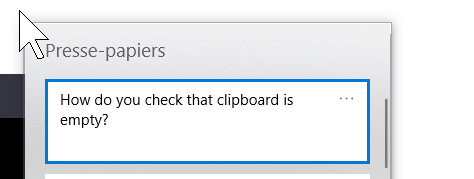

With Windows i can check by the key :
"win" + "v"
115362
22 267
5 853
22 267
5 853
When you press copy button in GPT, the content is copied to clipboard actually.
Now, you should use my code to get it.

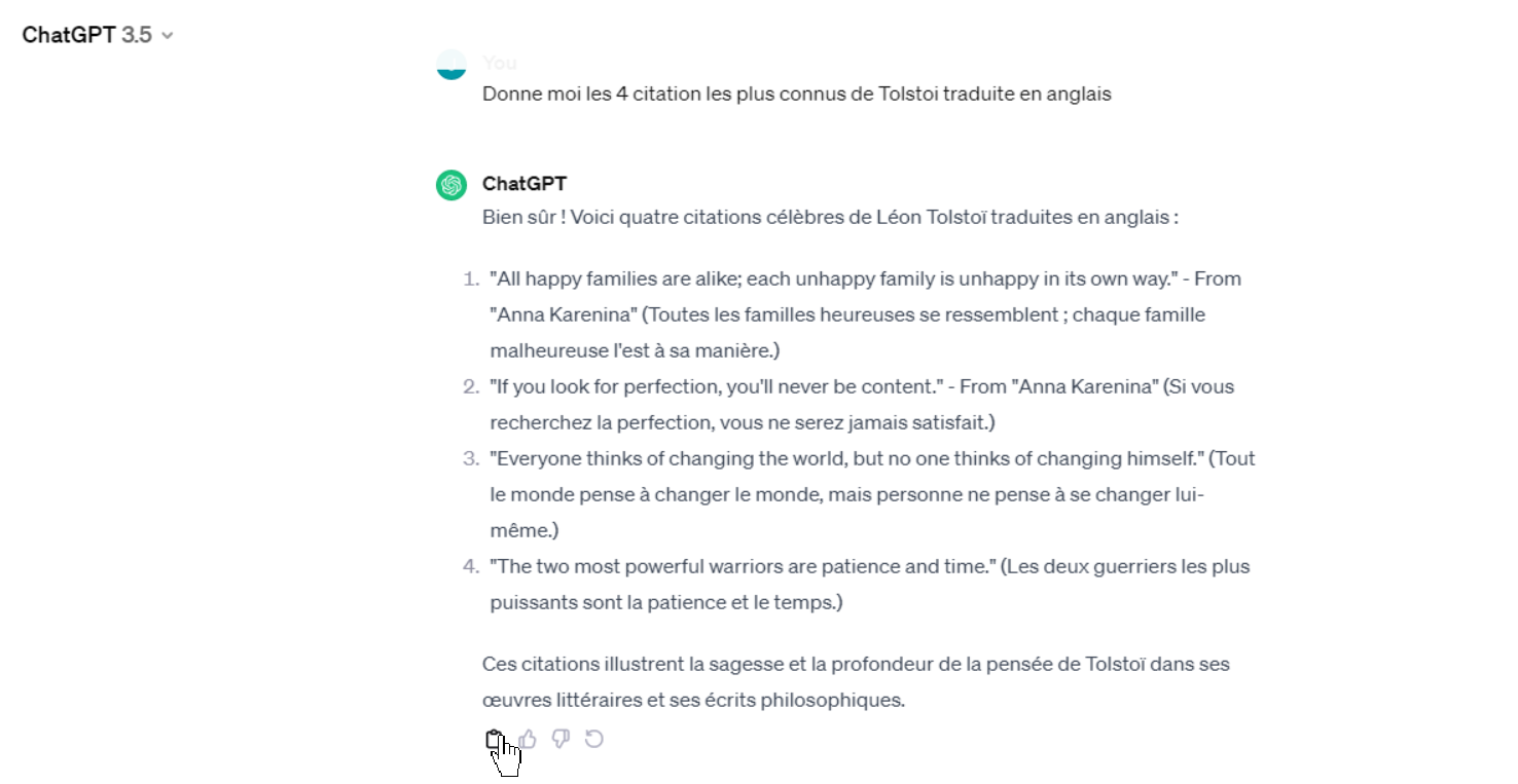

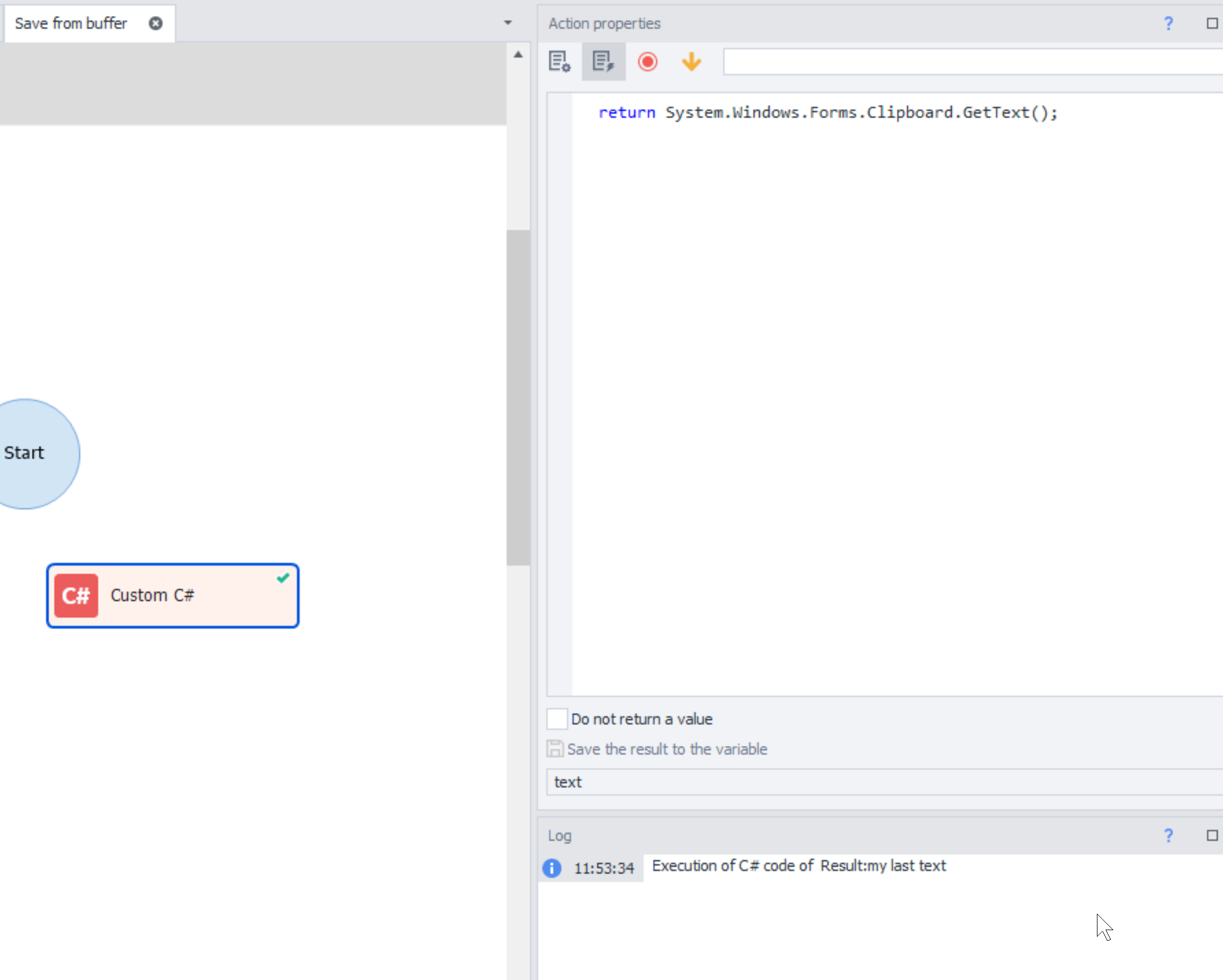

When you pressed copy buttin in GPT, the content was copied to clipboard.
That my trouble the content is not copied to clipboard
I am sorry i guess i miss something simple,

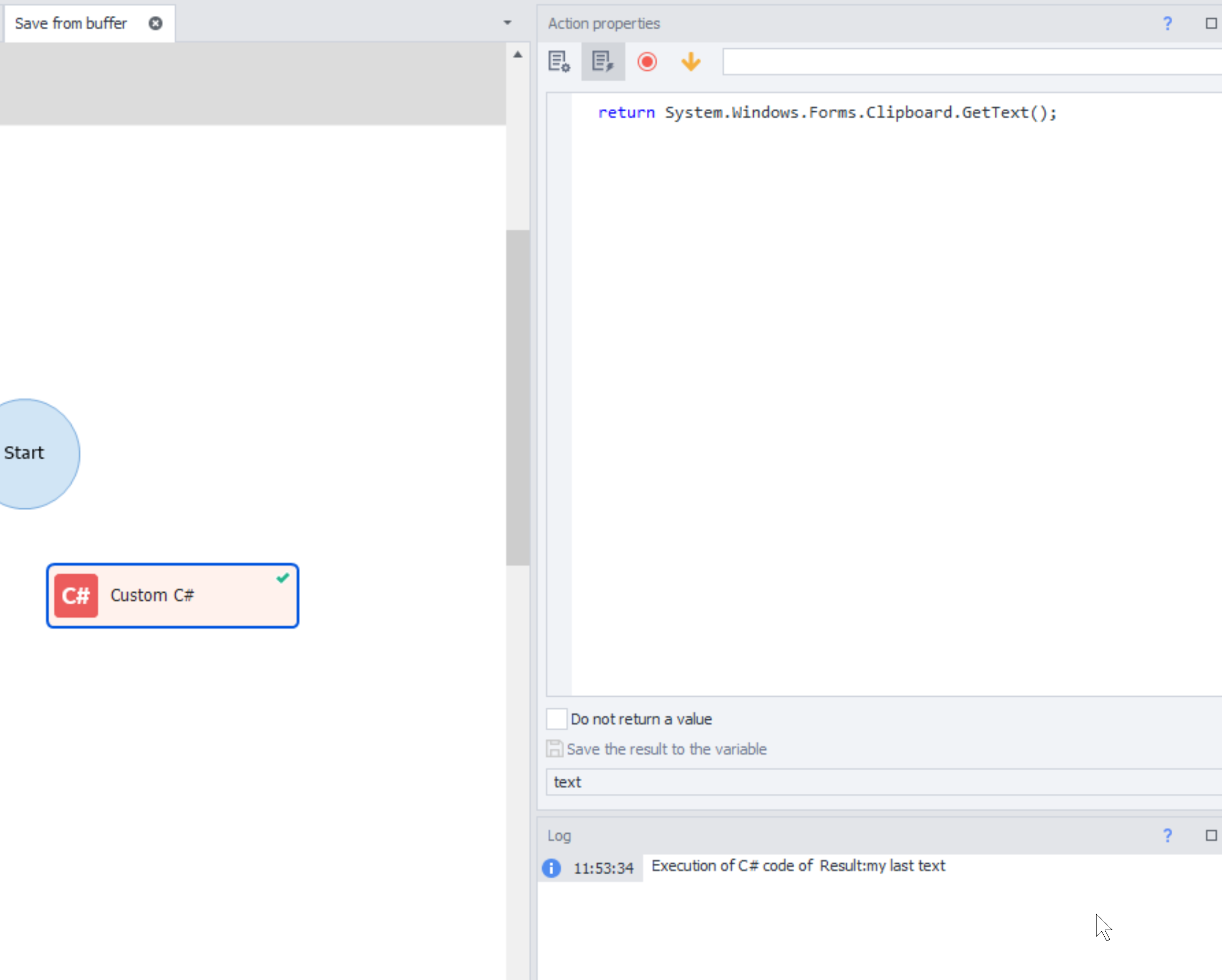

115381
When i click with zenno on this button (manually or by action designer)
i don't have any paste/forwarding in my clipboard,
So for instance juste after i clicked on the copy button even if use your code i am stuck with something else than the content of GPT,
but i get the last content of my clipboard for instance ( what i did for the demonstration) :
"my last text"
What it is logic,) I just show this to demonstrate that i didn't have the gpt content which was paste
115382
PS : If i copy the text by selection it, in this case it work it is paste to the clipbard but this is not the way i want to do
22 267
5 853

When you manually copy text by selection, it copies to Windows clipboard, not clipboard inside zennoposter.
Please copy my C# cube into your project, run it after pressing the button in ChatGPT and check copied content in the variable from C# cube.
That is how clipboard works inside zenno.

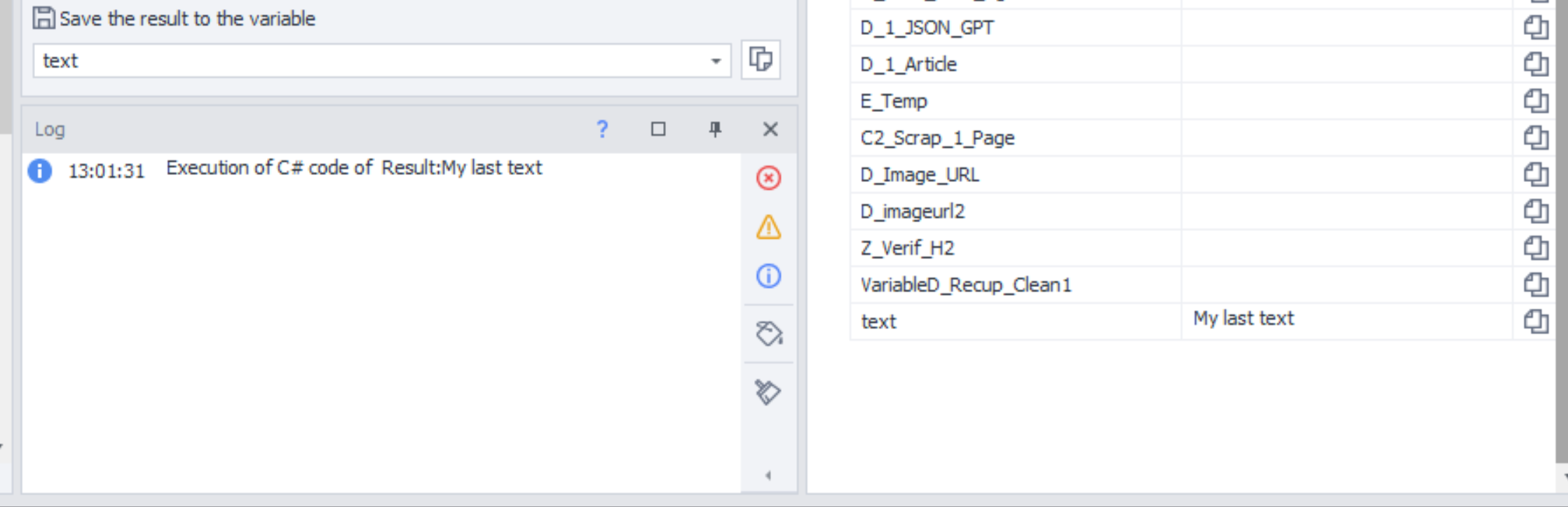

I have now implemented what you suggested in your last message,
I try also by integrated directly your C# code into my project and ran it after pressing the button in ChatGPT to check the copied content in the variable from the C# cube.
But when I simulate this click using ZennoPoster, the content does not seem to get copied to the clipboard at all.
So i can transmit to a variable...
To reiterate:
  1. I identify and click the "Copy" button using ZennoPoster's Action Designer.
  2. The expected outcome is that the content should then be on the clipboard, but it's not.
  3. Since the clipboard is empty, I can't move forward with the next step of saving this content into a variable.
My goal is to ensure that the simulated click in ZennoPoster triggers the JavaScript event just like a manual click does, so the content is actually copied to the clipboard. If there's a method to execute or trigger the associated JavaScript function directly within ZennoPoster, that would be incredibly helpful.
Thank you once again for your patience and assistance. Any further guidance on this matter would be greatly appreciated!
115389
