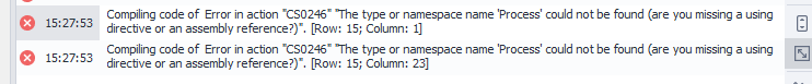

it was the . Right after . Variables
removed it now have this error
Compiling code of Error in action "CS0246" "The type or namespace name 'Process' could not be found (are you missing a using directive or an assembly reference?)". [Row: 15; Column: 1]
The error message says that you did not add using.
Try adding the full path like this:
// Process process = new Process();
System.Diagnostics.Process process = new System.Diagnostics.Process();
