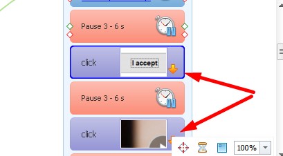

I am periodically running into this error code: Run HtmlElement | HTML element is not found by search criteria, however, I have set those conditions to Optional as shown in the screenshot.
That said, I would not expect it to return an error code at all. So I am not sure which exact step in my bot the log is pointing to. I see there is a "Copy Id of action" feature, but I am not sure how to use it and if it will help me isolate the exact step in my bot that it failed to find an htmlelement.
Thanks for any help.Посмотреть вложение 39732
You are a half way right.
In ZennoPoster copy ID of action.
Then go to Project Maker press CTRL+F and paste the ID of action.
You will then see what action made this error.
It won't be the one you marked as optional.

I found the culprit. Thanks for the tip.
