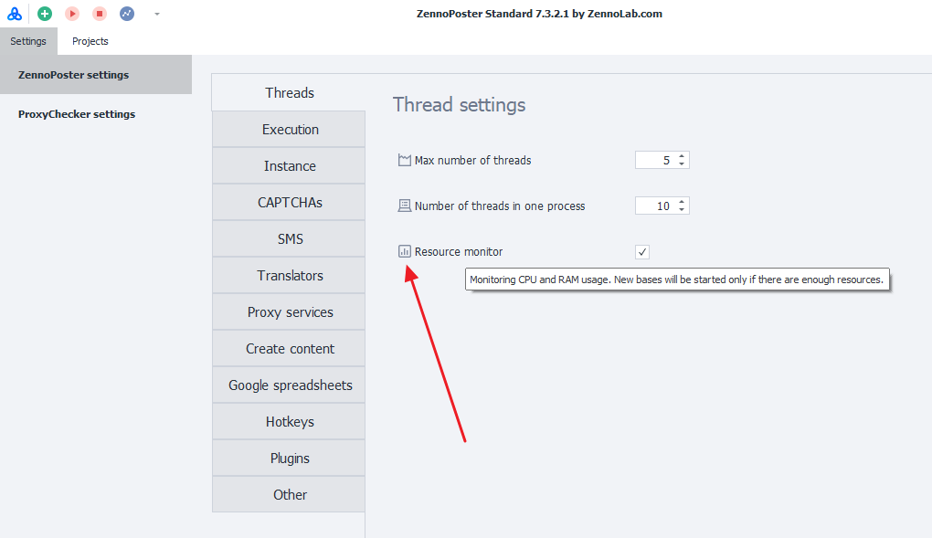

Is this option enabled in zennoposter settings?

After reviewing the logs, developers strongly advise you to enable resource monitor on both servers and see how it works.

According to logs, instance render process crashing causes memory leak which can be the reason for server overload. Therefore we recommend to enable resource monitor option.

Again I told resource monitor was enabled for one server, and there were no any differences, so no help from that.
