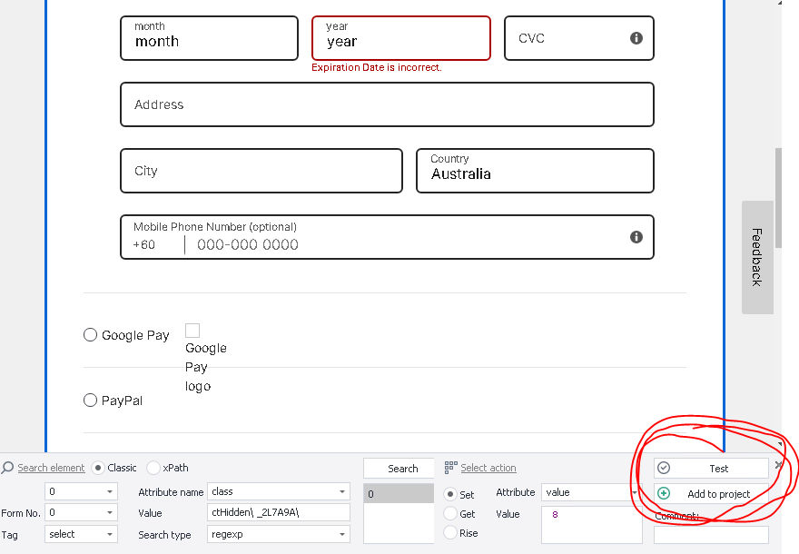

Hi guy, When i set value in dropdown in test model,, it always can be set successfully. But when i add it to project, the scripts will run, but the set value never works, why this happens?

Document No and Form No should be -1
This actually depends on element attribute.
You should find better attribute for element search to definitely find it.
You may also use Xpath for element searching
