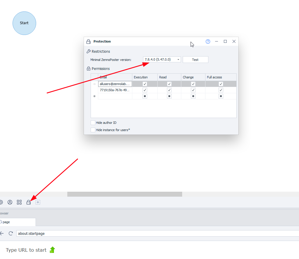

Apparently, you have to create common code block. Please downgrade version zennoposter in your template.
That doesn't help me at all. I don't know how to use the common code block or call it in the template.
Hi, Clint.
Open protection block and lower version and then save and re-upload template so I can get access to it.

Hi, Clint.
