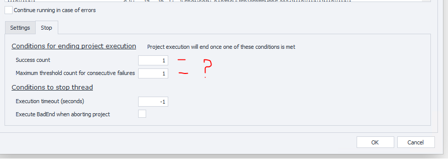

You should set Attemps count to 0 on settings tab.
Conditions for ending project execution, I would set -1.

I added modifications like you told me above. But still i got executions of templates many times in a row. What can i do to make task manager run in the right way.

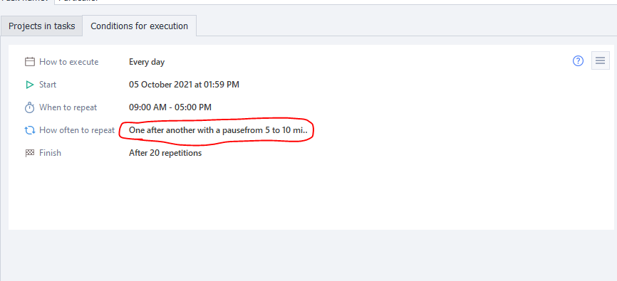

i deleted the looping template among the batch. And the task manager seems to load others correctly but now, i 'am facing problem about condition of execution. i plan one after another with pause (5 to 10 min). But the task manager is executing them WITHOUT pause.

How long is your project executed?
Schedule means pause between start time of each execution, not between previous execution end and next run start.
It's not possible to calculate when execution ends. So, you should increase pause time taking into account average project execution time

But unfortunetly in second batch attemp, many templates start looping although i set the correct parameters in " conditions for ending projects". They didn't stop until i delete them from the list on Task manager.

i adjusted range between executions with much more delay. But templates still loading when failing to execute, instead of switching to the next template on the list of the task manager. I 'am going crazy ! i need this stuff to manage schedule, please help guys !
