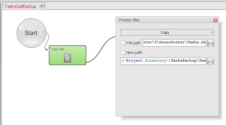

If I understand well, you could also just run a daily backup of the TASKS.DAT.
But maybe you mean something different.

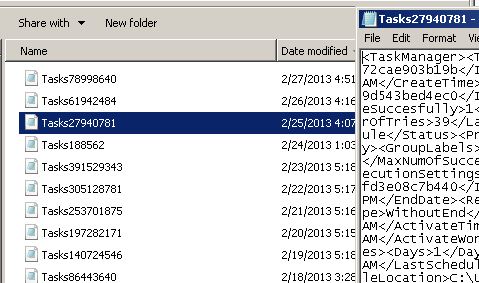

If it still happens it should be fixed. In one of the last versions there was a mention of "improvements to task saving"
I still run my timestamped backups to avoid just having empty backups or retyping.
And that works for me.
Letting this stop my work is not an option.
The problem is not about having empty backups, the problems is that when I replace the task.dat with a backup or manually copy and paste the text it gets empty again at the moment of open zenno again, I have to add all the templates manually
