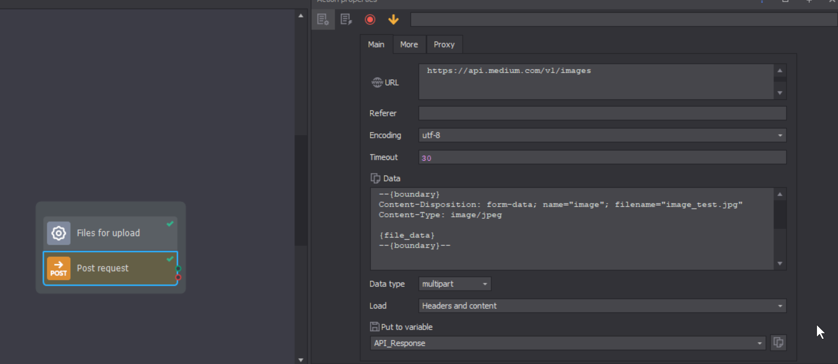

Hello ZennoPoster Community and HTTP Request expert!
I'm trying to upload an image to an API that requires multipart/form-data, similar to how I'd do in Postman, where it works fine. However, I'm facing difficulties getting ZennoPoster to recognize the file path and send the file. Below is the information I have:
  • URL: https://api.medium.com/v1/images
  • Method: POST
  • Headers:
    • Authorization: Bearer {API_Token}
    • Content-Type should be multipart/form-data (but I'm not sure how ZennoPoster handles this)
  • File Path: C:\Zeno\01 - Project\image_test.jpg
  • Variables: I'm using a variable for the API token, which works well in Postman.
I've tried configuring the action properties in ZennoPoster, but the file is not found in the specified path. The Postman export shows a successful request with formdata, but translating this into ZennoPoster's settings is proving challenging. Here’s the format I’m attempting to replicate from Postman:
plaintextCopy code
--BoundaryString
Content-Disposition: form-data; name="image"; filename="image_test.jpg"
Content-Type: image/jpeg
[Binary image data]
--BoundaryString--
Do I need to use the "File upload to server" block before making the POST request? I am new to development and appreciate simple and clear instructions.
I guess i am close but for sure i miss something!
Thank you in advance for your Expertise!
PS the doc :
120035
120036

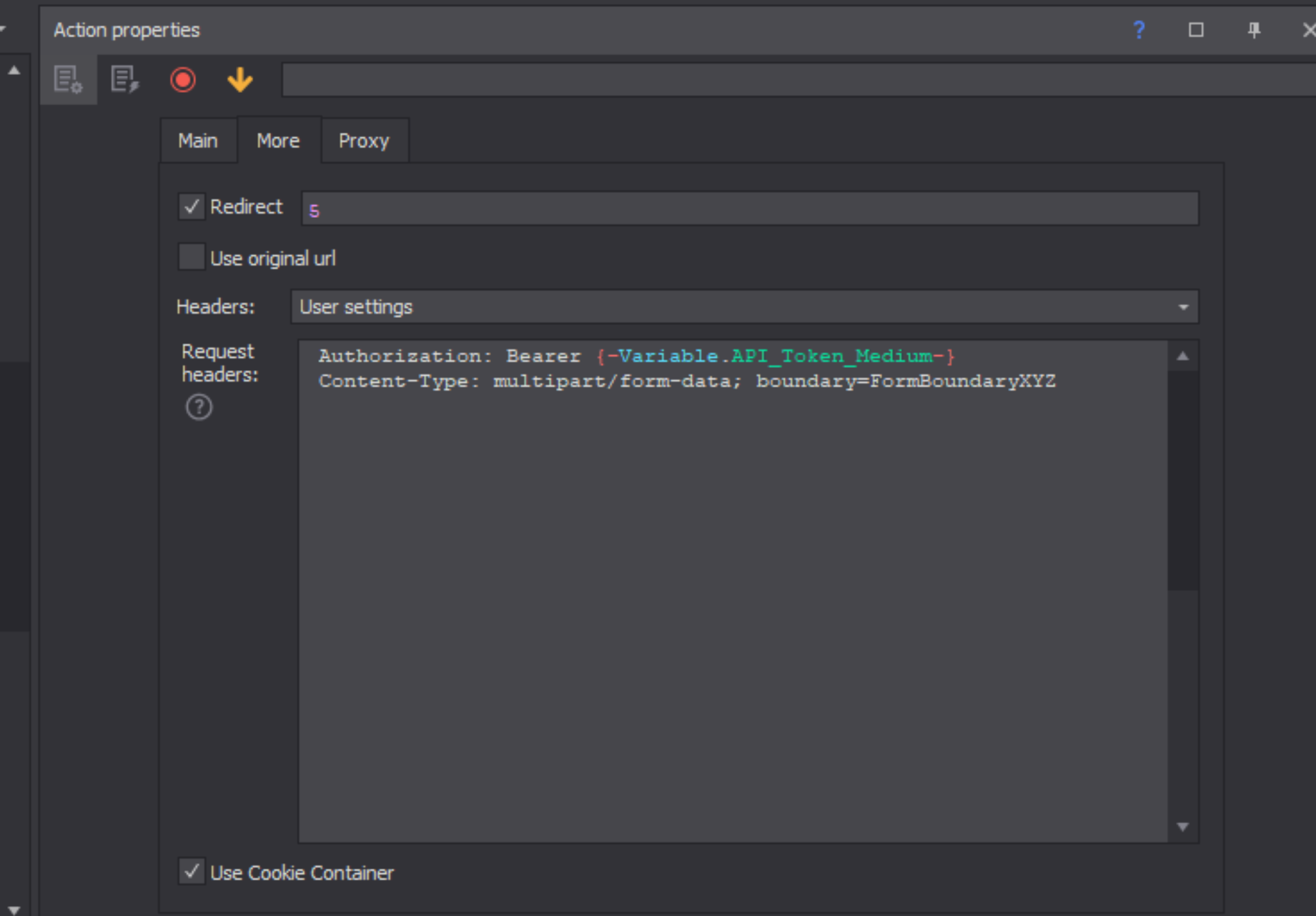

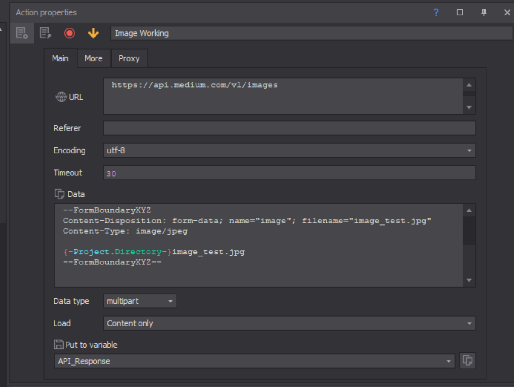

Thank @dzair for his precious and quality help :
With this setting it works!
--FormBoundaryXYZ
--FormBoundaryXYZ--
120044
Реакции: dzair
