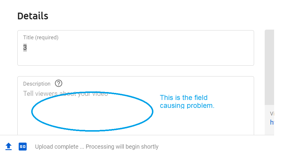

I want to read a text file and put its value into an input text box on a webpage (such as Youtube's title or description input fields when uploading a video).
So I first read the text file into a variable, then an action will put the value of the variable into the text boxes.
However, there are always an extra blank line generated for each line of text in the text file.

How can we solve this problem?
Thanks.

This option does not solve the problem.
It's the same whether it's on or off.
And very strangely, PM doesn't have this issue, but ZP does.
You can try it yourself. It's the description field for uploading Youtube videos.
The actions are attached here as well.

This is exactly the issue with input data matching.
what browser engine do you use in your project? Would recommend you to switch to Chrome.

I am using Chrome.
For now I use keyboard emulation with {ENTER} as a work around.

Try to decrease Input Emulation level. Set it to Speed or DOM events emulation.
You can do it globally for whole project:
70214
Or only for specific Action:
70216
Worked for me on 5.47 (both PM and ZP)
