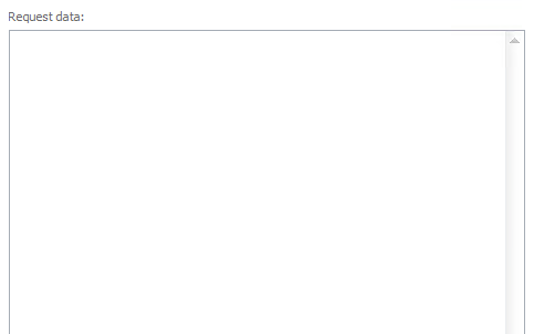

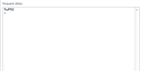

Thanks for the help but i dont think its working for me...
When i check the request traffic, this is what the request body looks like when i do it on the website
This is what the request body looks like when i try it with the code
Doesnt look like the file is being chosen properly?
