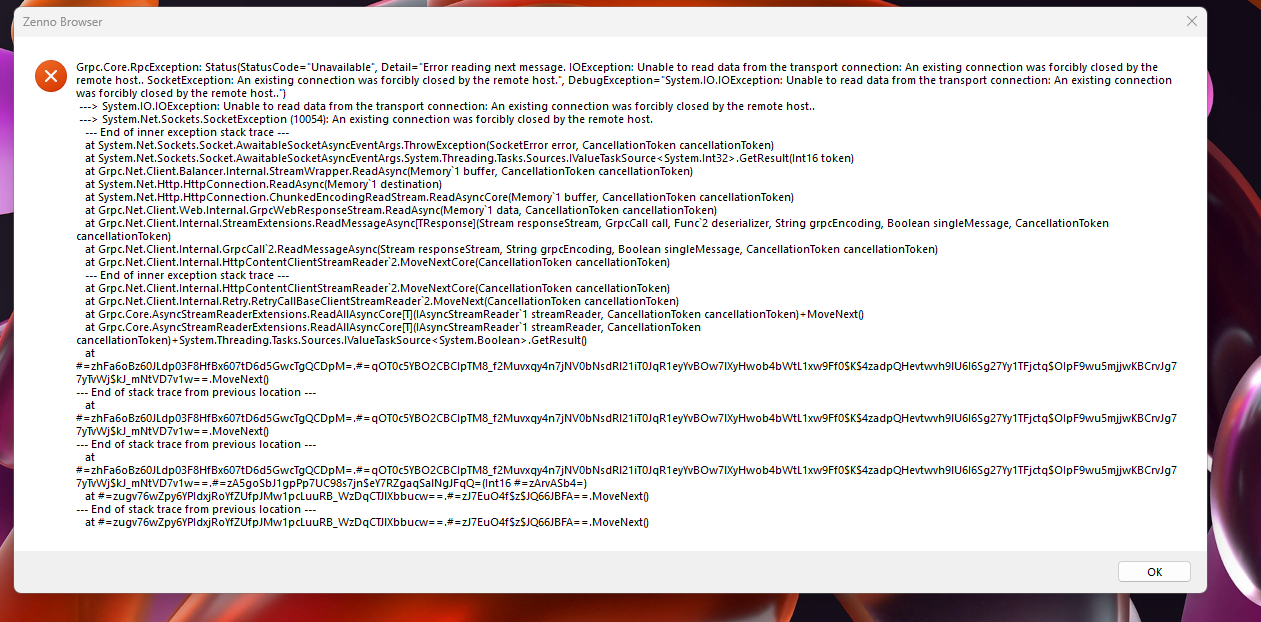

After the lastest update i keep getting this error. Everything worked fine, after the update i get this error after each restart of my modem, and also the thread remain active, and i have to restart the computer to get it back running. I have to restart it 5-10 times daily, so it's a big problem for me.
138110
and it keep freezing like this. I shows up as if it's running but it doesn't do anything.. Running the lastest version of zb and zp
138111

@VladZen it still there, it happens when i reset my modem, i reset it via zennobrowser, so when the internet goes off for 30-40 seconds it gives that error. I think if you guys increase the reconnect time to 2-3-4 minutes it should fix it. Attached its the print screen so you can see exactly whats going on
The old version worked perfectly, i runned my template for over 1 and half month on it, and never had a problem, so the old setting was ok.
Thank you for the details. There will be the fix for this error.
