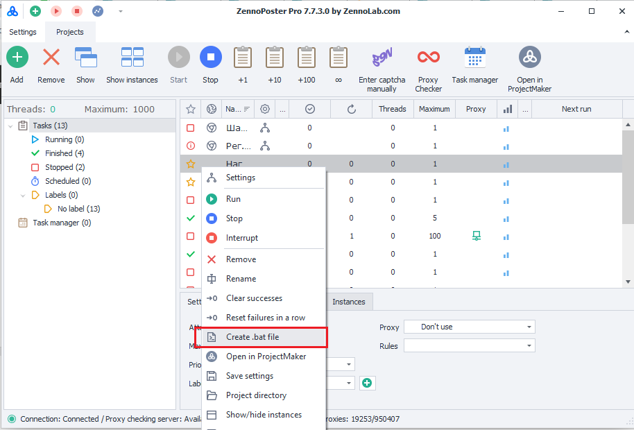

You can create bat file for your template
and if you call bat file somehow remotely, then it will run the template.

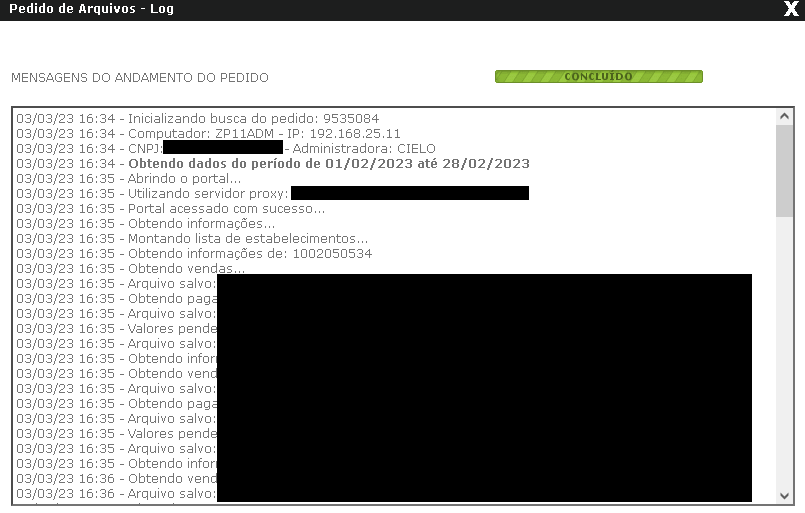

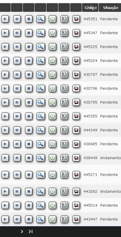

We can start, pause, stop, view log, schedule, view screenshots or write details about execution outside zenno.
As example. press play start a bot:
104702
Logs example:
104705
