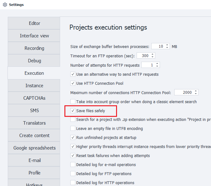

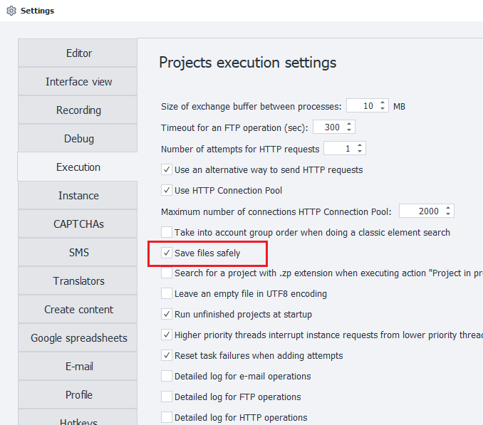

Hello,
I'm afraid it is not possible to recover corrupted txt file.
But, I can recommend to enable this option to work with files safely in ZennoPoster.
