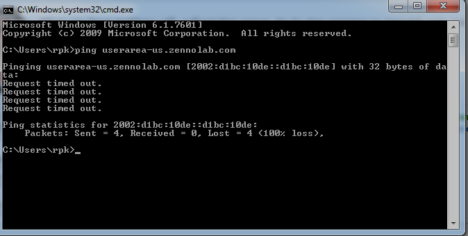

When you have problems with authorization server, try to ping userarea-us.zennolab.com and userarea.zennolab.com
Which IP will be shown?
Please attach screenshots
25.01.2015
22
25.01.2015
22
However it works with Hotspot shield which is quite slow

i hear that ZP work only ipv4. Rostonix, what you say about it?
